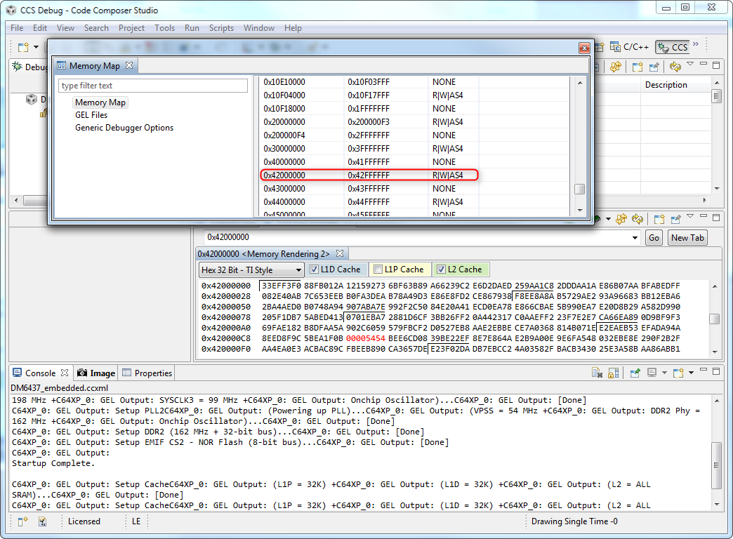

    Interesting, as I was able to properly write to the external SRAM using my DM6437 (C6424's sister device) without problems. Apart from an issue with the debugger itself (which I suggest checking the troubleshooting page), it may be something misconfigured in the memory map defined by the GEL file you are using. To inspect this, go to menu Tools --> Memory Map. Check the attached screen that highlights the change to the SRAM memory in the Memory Browser and the Memory Map defined by the GEL file.

  • Rafael,
    I have the same memory map configuration, but it doesn't work. In order to modify a single cell I have to use Memory Fill with Lenght=1.
    My colleague has the same behaviour. We are working with CCS 5.1 in Windows 7.
