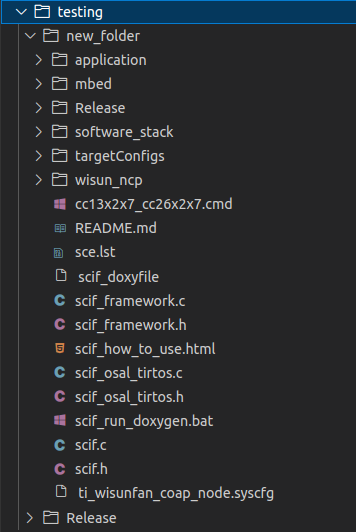

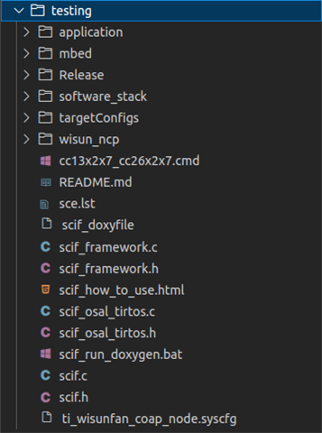

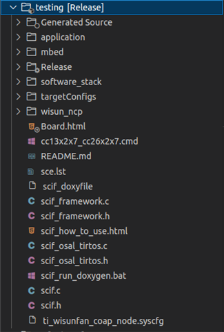

    Regardless the .cproject, .ccsproject and .project files, this is what I mean:
    If I remove those files, CCS does not recognize the project anymore and it seems to be just a folder:
    Based on this thread (CODECOMPOSER: What is required for CCS to detect a project?) it seems like those files are indeed necessary.
    Also, if I have a project and move all the TI files to a folder (like the following screenshot), CCS also stops recognizing the project:
    How can I manage to use this configuration?
    Eduardo.

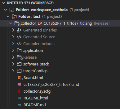

  • Hi Eduardo,
    1. Yes, the F2 SimpleLink SDK is both provided as an installation file from ti.com website, or as at GitHub repository from GitHub - TexasInstruments/simplelink-lowpower-f2-sdk: SimpleLink Low Power F2 SDK, the examples come as a git submodule. The instructions are provided in the README file.
    2. You can move the project into a subdirectory in the workspace by following this steps: 6.1. Creating and Managing Projects — Code Composer Studio 20.2.0 Documentation
    Daniel
