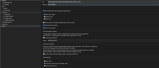

    • When I click on the project properties and select debug option, it appears to show this config(What is important here is the option of necessary sectors):
    • Then, when I go to the debug section, the option appear in the launch config.
    • Also, I check that in the folder .theia placed right above the our project where the ccs is placing the launch.json file.
    • When I click on the green button in the image above, and start a debug session, checking again the properties it clearly shows that the configuration is changed, and the option erase entire flash is selected. Also, I check through the memory browser a parameter written and it clearly shows that the parameter has disappeared.

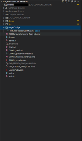

    Can you provide a screenshot of your Explorer view? I think you either opened the workspace folder to be your project folder or are working with a multi-root workspace. It is not clear based on your description so a screenshot will help explain it to me.
    ki
  • Sure, let me attach the screenshot.
    Also, let me add the following: The .theia file is in two places. One inside this folder and another one in the parent directory where this folder is located. Both have the same exact launch file
  • Based on your screenshot it looks like you once had a multi-root workspace environment and then removed one of the roots (folder) to have a single root workspace save to the workspace file. That single root contains on project.
    Is that correct?
