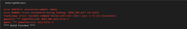

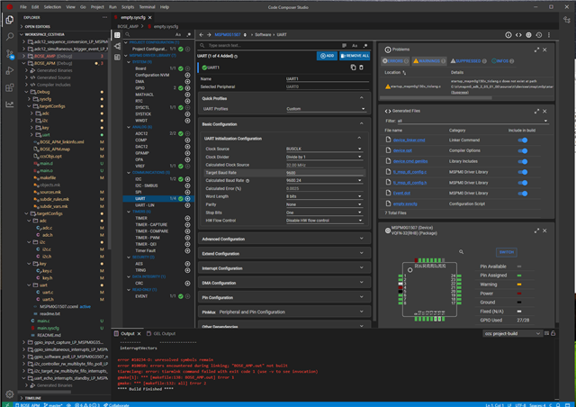

    I would like to ask about the following issue:

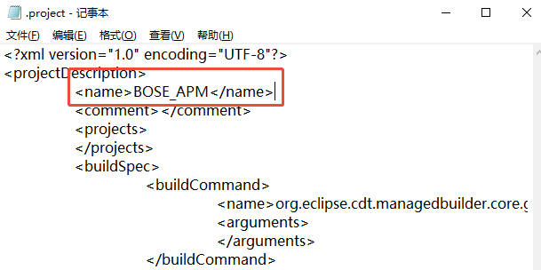

    I modified the project name in the .project file, but later changed it back.
Why do I still get the following error when compiling the project?
Moreover, when I create a new empty project and compile it, this same error also occurs.
    Robert
  • It's interruptVectors error.
    It seems that you didn't add avaliable startup file to project.
    Recommend step:
    1. Download MSPM0 SDK.
    2. Download CCS, install with MSPM0 support package.
    3. Import project from MSPM0SDK: File - Import project

    Please check whether your project has a valid startup source file or .o(In debug folder) file like below:
    startup_mspm0g350x_ticlang.o
    C:\ti\mspm0_sdk_2_03_00_07\source\ti\devices\msp\m0p\startup_system_files\ticlang\startup_mspm0g350x_ticlang.c
    Compiler/linker report the error that can not find the interruptVectors and interruptVectors  is from startup file.

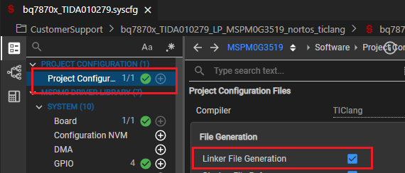

    There is also startup file generation check box in syscfg - project configuration

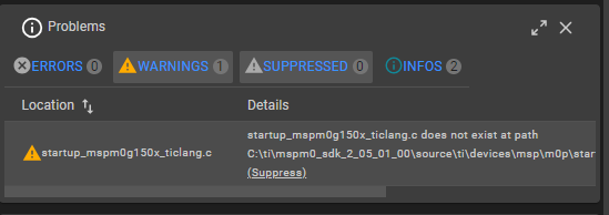

  • Yes, you are really impressive. I found that there is no startup_mspm0g150x_ticlang.c file in the SysConfig project configuration, and it is also missing from the path folder. I'm not sure why the program was running normally before.
    Could you please let me know how to obtain the startup_mspm0g150x_ticlang.c file? I would greatly appreciate it.
  • 1. If there is no startup in your project, you can directly copy one from SDK to you project root folder.
    2. You can try to enable it in syscfg:
    3. Or, if you want, you can setup a new project that using default syscfg file, syscfg will generate the startup file for you like this:

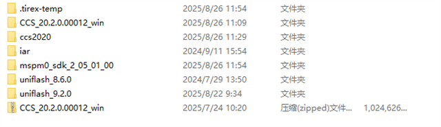

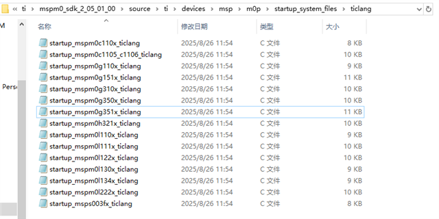

        The file
    startup_mspm0g150x_ticlang.c was indeed missing from my path C:\ti\mspm0_sdk_2_03_00_07\source\ti\devices\msp\m0p\startup_system_files\ticlang. I downloaded the new MSPM0 SDK, which includes the startup_mspm0g150x_ticlang.c file.

        I'm sorry to disturb you. I need your help because the previous issue has occurred again.
        It reported the previous error again, but this time my startup_mspm0g150x_ticlang.c is present.
        I would like to ask you how to resolve this issue. I look forward to your reply.
        Robert
  • You are using these two functions but compiler can not find them:
