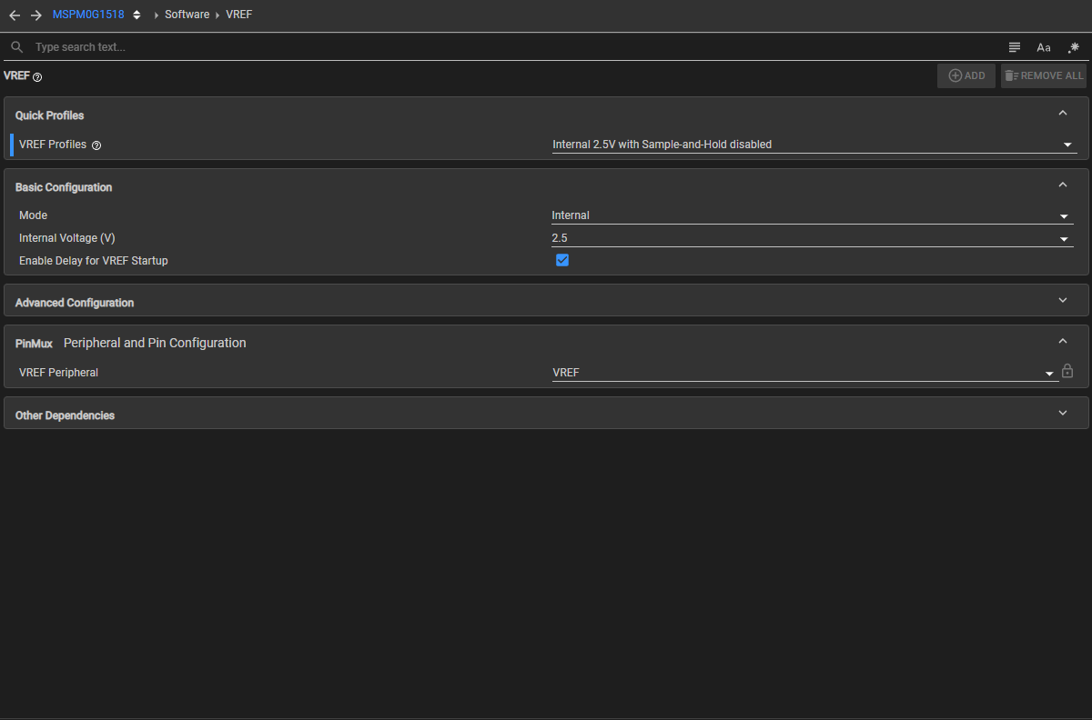

in a project we are using the MSPM0G1518 (LQFP-64) and for firmware development the LP-MSPM0G3519.
When configuring the MCU using the Sysconfig (v1.25.0+4268) in CCS (v20.3.0) the option to assign a pin for outputting the internal reference voltage is missing. The 2.5V is present at PA23/24, though the pin can be configured for use as GPIO, since its not blocked by the VREF peripheral.
MSPM0G1518

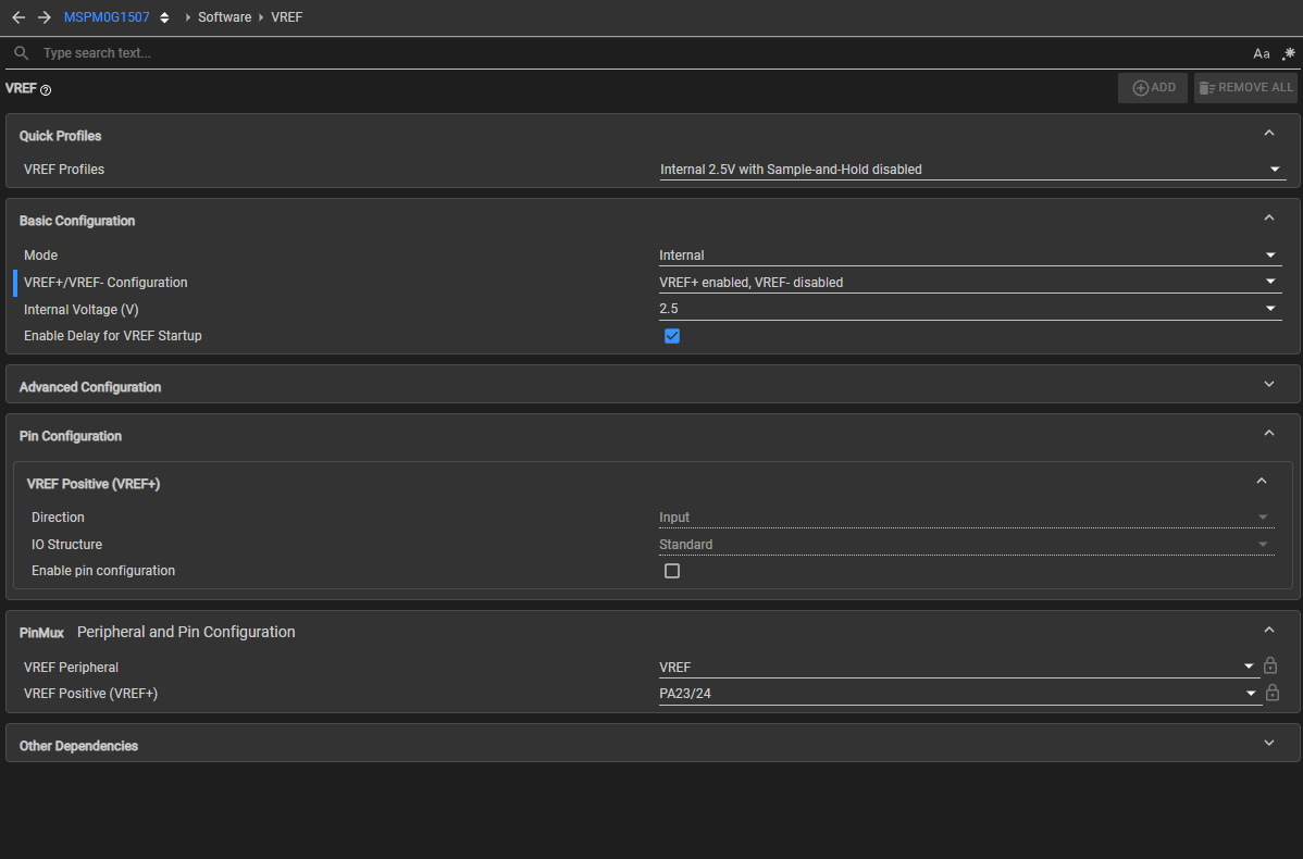

In another project we use the MSPM0G1507, where this option is available in the syscfg.
MSPM0G1507
In case VREF still offers the capabilities to deliver a reference voltage to other circuitry this is not a major issue, though it could lead to confusion when configuring pins. But maybe I'm missing something...
