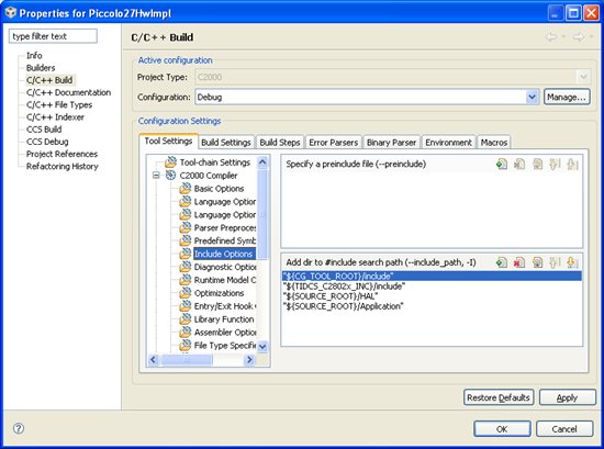

2) I update the include paths in the project properties to use the new linked resources, using the ${ } macro expansion syntax it describes, which is matched by that for the predefined CG_TOL_ROOT:

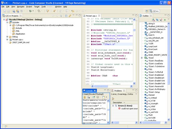

3) However, when I do the build the files in these directories are not foung, and it appears that the linked resources did not get macro-expanded at all as shown in the highlighted text below which appears in the Console window.  This remains the case even after exiting and relaunching CCS 4.2.5.00005, and even after reboot.  I am also puzzled by the expansion that did succeed, since C:/Program Files/Texas Instruments/ccsv4/tools/compiler/c2000 is defined to be CCS_C2000_6_0_1_CG_ROOT rather than CG_TOOL_ROOT as shown above, although they are clearly related.
The failing #include file is #include'd by a version of DSP2802x_Device.h residing in the project directory which I modified to accommodate local typedefs.
**** Build of configuration Debug for project Piccolo27HwImpl ****
C:\Program Files\Texas Instruments\ccsv4\utils\gmake\gmake -k all
'Building file: C:/Products/bassettb_IFOURXX_4/ifx_Controller/Code/ControllerProcessor/Piccolo/PicUart.cpp.c'
'Invoking: Compiler'
"C:/Program Files/Texas Instruments/ccsv4/tools/compiler/c2000/bin/cl2000" -v28 -mt -ml -g --include_path="C:/Program Files/Texas Instruments/ccsv4/tools/compiler/c2000/include" --include_path="/include" --include_path="/HAL" --include_path="/Application" --diag_warning=225 --preproc_with_compile --preproc_dependency="PicUart.cpp.pp" "C:/Products/bassettb_IFOURXX_4/ifx_Controller/Code/ControllerProcessor/Piccolo/PicUart.cpp.c"
"C:\Products\bassettb_IFOURXX_4\ifx_Controller\Code\ControllerProcessor\Piccolo\Modified_DSP2802x_Device.h", line 132: fatal error: could not open source file "DSP2802x_Adc.h"
1 fatal error detected in the compilation of "C:/Products/bassettb_IFOURXX_4/ifx_Controller/Code/ControllerProcessor/Piccolo/PicUart.cpp.c".
Compilation terminated.
>> Compilation failure
gmake: *** [PicUart.cpp.obj] Error 1
gmake: Target `all' not remade because of errors.
Build complete for project Piccolo27HwImpl

    Before you compile the project, do the folders ../DSP2802x_headers/include, ../ControllerProcessor/Hal and ../ControllerProcessor/Application appear under your C/C++ Projects Tab -> Piccolo27HwImpl-> include ? If they do appear, you should be able to see the files inside each document.

    In response to your other question, the include directories appear, but exactly as they do in the command line in the Console window, i.e. without the benefit of the symbol expansion, as you can see below.  The statement "To use the linked variable in a project as part of the #include file directory search path, simply surround the linked variable with curly brackets and add a “$” in front."in that section of the page seems not to be operative, since that's what appears in the Project Properties' Tool Settings tab under C2000 Compiler. Include Options as shown in my original post, matching the example of CG_TOOL_ROOT.  What am I missing here?

    If you want to use macros to specify compiler include paths you would need to create a build macro (similar to the linked resource macro you created above). This macro needs to be defined under Window->Preferences->C/C++->Managed Build, Macros tab. You can go in here and create a build macro with the same name as your linked resource macro, and then it should resolve correctly in the compiler include path.
    The wiki page you were looking at is not quite clear in this respect because it is written with the assumption that a user will also be creating a macros.ini file to make the project portable. If the macro is added to a macros.ini file then during import that macro will be resolved as both a linked resource variable as well as a build variable. However, if you are manually creating the project and haven't yet created the macros.ini,  then you would need to define the macro as a build macro in order to use it the compiler include path.
