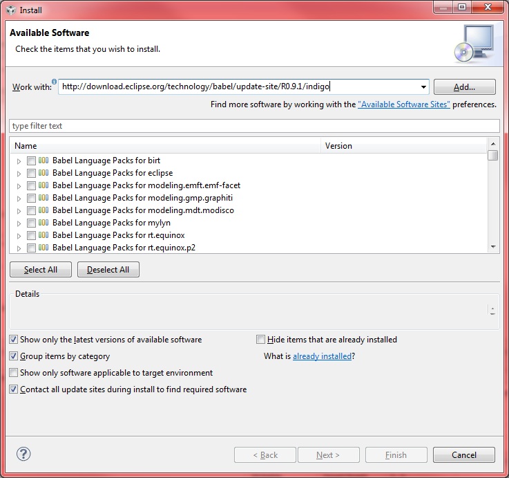

  • Hi Ayus,
    I think the best thing to do then is to install it directly from withing CCS.  I can see about updating the wiki,  but as these are eclipse plug-ins which don't come from us and many of us don't use, it is not always easy to keep on top of things every time a link or version or information about their product changes.
    Please go to Help->Install new software and enter this URL (below) as in the screenshot to add the language pack to CCS.
    http://download.eclipse.org/technology/babel/update-site/R0.9.1/indigo
    Please keep us informed.
    Lisa

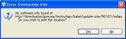

    We are having  problem in installing Language Pack to the latest CCSv5.4.
    The update site mentioned in the below site is not working..
    http://processors.wiki.ti.com/index.php/Language_Pack_Installation
    Please let me know the proper update site to install Language Pack.
    Best Regards.
    Prad
  • Try this site for CCS v5.4:
    http://download.eclipse.org/technology/babel/update-site/R0.10.1/indigo
    Thank you.,  I tried but it says
    Error Contacting Site as shown below.
  • The link seems to be working for me. Could you check the "-" in "update-site" to make sure the cut-and-paste didn't change it to a different character? I've had that problem when using Outlook.
    FYI, the sites are linked from this page: http://www.eclipse.org/babel/downloads.php  What you want is the language pack for Indigo.
  • Thank you Andy,
    It is now working properly....
