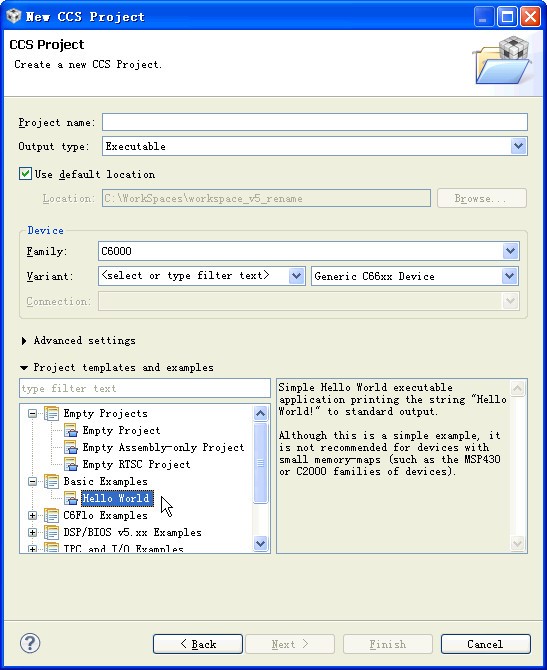

1. A "Hello World" example in creating project wizard has no renaming issue at all.

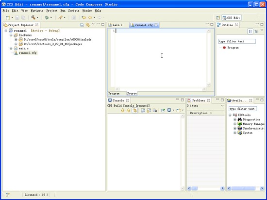

2.1 Create an empty RTSC project using wizard:
2.2 select no package support

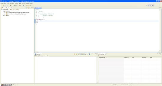

2.3 create an .c file and add a empty main
2.4 Add a empty RTSC .cfg file to avoid comiling error

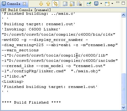

2.5 compile

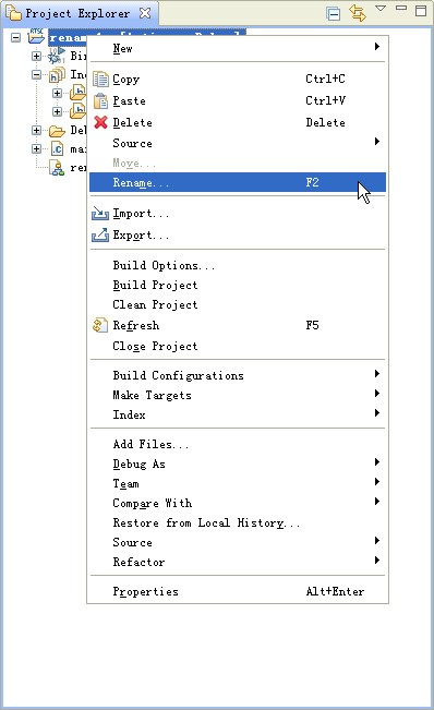

2.6 trying to rename the project
and error appear
2.7 note the project name shown is renamed
