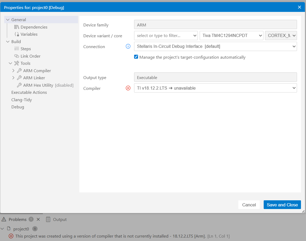

I imported project0 from the examples for the EK-TM4C1294XL using Resource Explorer.
Contents of the project that could be copied:
project0.c startup_ccs.c

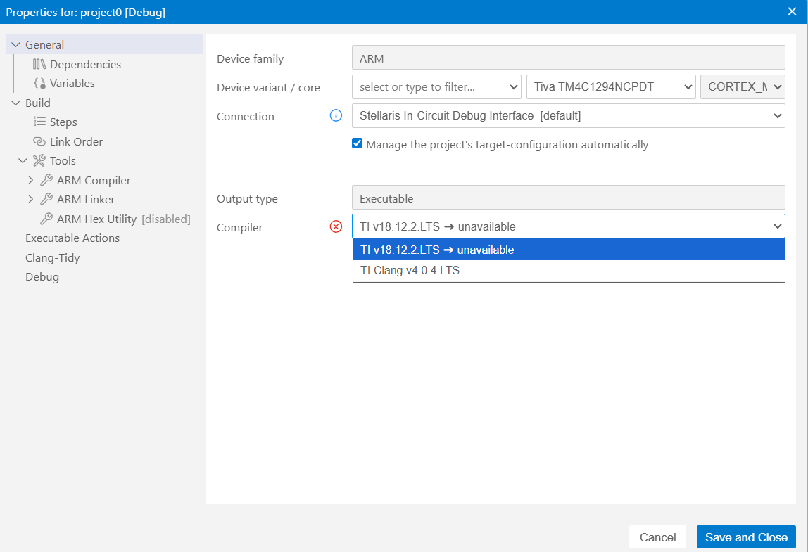

When I check the project properties:
I check the compiler dropdown
and select the only compiler available (TI Clang v4.0.4.LTS)
CCS performs migration tasks that result in the following log file: project.log
Nothing in the forums seemed to match, so I'm trying a new post.
