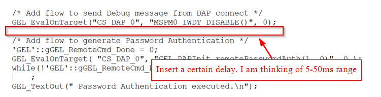

I want add a certain delay in gel files between two operations below:
Is there a easier way to achieve it? Thanks!

Really the only way is to add a crude C style "while" or "for" loop. GEL is not really designed for such behavior.
