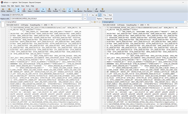

    we are not using CodeComposerStudio, we have our own build system
    The two command lines are
    "D:\JSB\FIAT520_354\TOOLS\CODEGEN\Bin\armcl.exe" -DCR4_ONLY=1 -DCM3_ONLY=0 -DWM_SW_VERSION=\""KJEA17 "\" -DNO_CANAPE_CAL -DMAKE2000 -DWM_USER_NAME=\""MBAUER"\" -DABS_ENABLED=TRUE -DAC_ENABLED=TRUE -DAMSC_ENABLED=TRUE -DARB_ENABLED=TRUE -DARM_ENABLED=TRUE -DBDC_ENABLED=TRUE -DBHM_ENABLED=TRUE -DBTC_ENABLED=TRUE -DCC_ENABLED=TRUE -DCHASSINF_ENABLED=TRUE -DCOMMS_ENABLED=TRUE -DCUSTBSW_ENABLED=TRUE -DCUSTPSW_ENABLED=TRUE -DDAQ_ENABLED=TRUE -DDB_ENABLED=FALSE -DDIAG_ENABLED=TRUE -DDST_ENABLED=TRUE -DEDTR_ENABLED=TRUE -DEYT_ENABLED=FALSE -DFM_ENABLED=TRUE -DHBA_ENABLED=TRUE -DHMI_ENABLED=TRUE -DIB_ENABLED=TRUE -DITPM_ENABLED=FALSE -DIO_ENABLED=TRUE -DLC_ENABLED=TRUE -DMM_ENABLED=TRUE -DOS_ENABLED=TRUE -DPBC_ENABLED=FALSE -DPBI_ENABLED=TRUE -DRB_ENABLED=FALSE -DSA_ENABLED=TRUE -DSC_ENABLED=TRUE -DSSM_ENABLED=TRUE -DSTC_ENABLED=FALSE -DTBS_ENABLED=TRUE -DTC_ENABLED=TRUE -DTIB_ENABLED=TRUE -DTPI_ENABLED=TRUE -DYIB_ENABLED=TRUE -DBHS_ENABLED=TRUE -DVWE_ENABLED=FALSE -DYSC_ENABLED=TRUE -DWM_SW_INFO=\""KJEA17 "\" -DDST_THIRD_PARTY=TRUE -DMKS_SECTION_ID=0x01 -DMKS_PROJECT_ID=3 -DMKS_CHECKPOINT_ID1=1808978 -DMKS_CHECKPOINT_ID2=0 -DTRW_SW_VERSION=\""AR"\" -DTRW_SW_INTEG_VERSION=\""02"\" -DTRW_SW_ID=\""KJEB25AR02"\" -DTRW_SW_NUMBER=\""KJEB25AR_02"\" -DFIAT_SW_NUMBER=\""KJEB25AR_02"\" -DCAL_COMPATIBILITY=0x00000008 -DCAL_REVISION=0x20 -DTRW_HW_NUMBER=\""EPB01316B7C"\" -DTRW_HW_VERSION=0x44 -DMAKE_DRAWING_NO=\""52254848 "\" -DMAKE_DRAWING_NO_AFTERMARKET=\"" "\" -DMAKE_HOMOLOGATION_CODE=\"" "\" -DMAKE_ISO_CODE_1=0x20 -DMAKE_ISO_CODE_2=0x8D -DMAKE_ISO_CODE_3=0x50 -DMAKE_ISO_CODE_4=0x06 -DMAKE_ISO_CODE_5=0x00 -DDEBUG_OFF -DDEVEL_OFF -DSIMULATION_CIAT_HIL_OFF -DENABLE_XCP=FALSE -DABS_ONLY_OFF -DIIS_ECU_IN_LOOP_TEST=0 -DIIS_BENCHMARK_ENABLED=FALSE -DLOGGER_200HZ -DAC_CALIBRATION_OFF -DSYSTEM_TESTRIG=FALSE -DOSEK_BUILD=NO_EXTENDED -DESCL_CONTROL=FALSE -DTPM_OFF=0 -DTPM_ON=1 -DTPM=TPM_ON -DTPI_LOGGER_OFF=0 -DTPI_LOGGER_ON=1 -DTPI_LOGGER=TPI_LOGGER_OFF -DMULECAR_COMMS=FALSE -DDISABLE_CRC_COMMS=FALSE -DDISABLE_COUNT_COMMS=FALSE -DDST_3RD_PARTY_EXECUTION -DHW_VARIANT_ESC=1 -DHW_VARIANT_MABS=2 -DHW_VARIANT=HW_VARIANT_ESC -DTMS570PSF762=1 -DTMS570PSFC62=2 -DTMS570PSFD62=3 -DTMS570PSFC66=4 -DTMS470M066X=5 -DTMS570LS3137=6 -DTMS570LC4357=7 -DTMS570LS2135=8 -DTMS570LS1213=9 -DCPU_VARIANT=TMS570LS1213 -n -ea.CASM -mt -pdf -mv=7R4 --symdebug:dwarf --optimize_with_debug --c_src_interlist --optimizer_interlist -ms --abi=eabi --gcc --opt_level=4 -mn -pden -pdse47 -pdse48 -pdse69 -pdse70 -pdse118 -pdse169 -pdse189 -pdse190 -pdse193 -pdse195 -pdse225 -pdse261 -pdse262 -pdse551 -pdse990 -pdse994 -pdse1027 -pdse1037 -pdse1106 -pdse1110 -pdse1238 -pdsr9 -fsD:\JSb\Fiat520_354\MainMicro\Application\YIB\YIB_MAIN\SOURCE\..\BUILD\KJEA17_MM_APP\ASM\ -ftD:\JSB\FIAT520_354\BUILD\KJEA17_MM_APP\TEMP -iD:\JSB\FIAT520_354\MainMicro\application -iD:\JSB\FIAT520_354\MainMicro\calibration -iD:\JSB\FIAT520_354\Shared -fcD:\JSb\Fiat520_354\MainMicro\Application\YIB\YIB_MAIN\SOURCE\yib_lat_accel_signals.c -pdel 99999
    "C:\SW\KJEB25AR_INTEG2_354_LOCALLY\TOOLS\CODEGEN\Bin\armcl.exe" -DCR4_ONLY=1 -DCM3_ONLY=0 -DWM_SW_VERSION=\""KJEA17 "\" -DNO_CANAPE_CAL -DMAKE2000 -DWM_USER_NAME=\""MBAUER"\" -DABS_ENABLED=TRUE -DAC_ENABLED=TRUE -DAMSC_ENABLED=TRUE -DARB_ENABLED=TRUE -DARM_ENABLED=TRUE -DBDC_ENABLED=TRUE -DBHM_ENABLED=TRUE -DBTC_ENABLED=TRUE -DCC_ENABLED=TRUE -DCHASSINF_ENABLED=TRUE -DCOMMS_ENABLED=TRUE -DCUSTBSW_ENABLED=TRUE -DCUSTPSW_ENABLED=TRUE -DDAQ_ENABLED=TRUE -DDB_ENABLED=FALSE -DDIAG_ENABLED=TRUE -DDST_ENABLED=TRUE -DEDTR_ENABLED=TRUE -DEYT_ENABLED=FALSE -DFM_ENABLED=TRUE -DHBA_ENABLED=TRUE -DHMI_ENABLED=TRUE -DIB_ENABLED=TRUE -DITPM_ENABLED=FALSE -DIO_ENABLED=TRUE -DLC_ENABLED=TRUE -DMM_ENABLED=TRUE -DOS_ENABLED=TRUE -DPBC_ENABLED=FALSE -DPBI_ENABLED=TRUE -DRB_ENABLED=FALSE -DSA_ENABLED=TRUE -DSC_ENABLED=TRUE -DSSM_ENABLED=TRUE -DSTC_ENABLED=FALSE -DTBS_ENABLED=TRUE -DTC_ENABLED=TRUE -DTIB_ENABLED=TRUE -DTPI_ENABLED=TRUE -DYIB_ENABLED=TRUE -DBHS_ENABLED=TRUE -DVWE_ENABLED=FALSE -DYSC_ENABLED=TRUE -DWM_SW_INFO=\""KJEA17 "\" -DDST_THIRD_PARTY=TRUE -DMKS_SECTION_ID=0x01 -DMKS_PROJECT_ID=3 -DMKS_CHECKPOINT_ID1=1808978 -DMKS_CHECKPOINT_ID2=0 -DTRW_SW_VERSION=\""AR"\" -DTRW_SW_INTEG_VERSION=\""02"\" -DTRW_SW_ID=\""KJEB25AR02"\" -DTRW_SW_NUMBER=\""KJEB25AR_02"\" -DFIAT_SW_NUMBER=\""KJEB25AR_02"\" -DCAL_COMPATIBILITY=0x00000008 -DCAL_REVISION=0x20 -DTRW_HW_NUMBER=\""EPB01316B7C"\" -DTRW_HW_VERSION=0x44 -DMAKE_DRAWING_NO=\""52254848 "\" -DMAKE_DRAWING_NO_AFTERMARKET=\"" "\" -DMAKE_HOMOLOGATION_CODE=\"" "\" -DMAKE_ISO_CODE_1=0x20 -DMAKE_ISO_CODE_2=0x8D -DMAKE_ISO_CODE_3=0x50 -DMAKE_ISO_CODE_4=0x06 -DMAKE_ISO_CODE_5=0x00 -DDEBUG_OFF -DDEVEL_OFF -DSIMULATION_CIAT_HIL_OFF -DENABLE_XCP=FALSE -DABS_ONLY_OFF -DIIS_ECU_IN_LOOP_TEST=0 -DIIS_BENCHMARK_ENABLED=FALSE -DLOGGER_200HZ -DAC_CALIBRATION_OFF -DSYSTEM_TESTRIG=FALSE -DOSEK_BUILD=NO_EXTENDED -DESCL_CONTROL=FALSE -DTPM_OFF=0 -DTPM_ON=1 -DTPM=TPM_ON -DTPI_LOGGER_OFF=0 -DTPI_LOGGER_ON=1 -DTPI_LOGGER=TPI_LOGGER_OFF -DMULECAR_COMMS=FALSE -DDISABLE_CRC_COMMS=FALSE -DDISABLE_COUNT_COMMS=FALSE -DDST_3RD_PARTY_EXECUTION -DHW_VARIANT_ESC=1 -DHW_VARIANT_MABS=2 -DHW_VARIANT=HW_VARIANT_ESC -DTMS570PSF762=1 -DTMS570PSFC62=2 -DTMS570PSFD62=3 -DTMS570PSFC66=4 -DTMS470M066X=5 -DTMS570LS3137=6 -DTMS570LC4357=7 -DTMS570LS2135=8 -DTMS570LS1213=9 -DCPU_VARIANT=TMS570LS1213 -n -ea.CASM -mt -pdf -mv=7R4 --symdebug:dwarf --optimize_with_debug --c_src_interlist --optimizer_interlist -ms --abi=eabi --gcc --opt_level=4 -mn -pden -pdse47 -pdse48 -pdse69 -pdse70 -pdse118 -pdse169 -pdse189 -pdse190 -pdse193 -pdse195 -pdse225 -pdse261 -pdse262 -pdse551 -pdse990 -pdse994 -pdse1027 -pdse1037 -pdse1106 -pdse1110 -pdse1238 -pdsr9 -fsC:\sw\KJEB25AR_INTEG2_354_locally\MainMicro\Application\YIB\YIB_MAIN\SOURCE\..\BUILD\KJEA17_MM_APP\ASM\ -ftC:\SW\KJEB25AR_INTEG2_354_LOCALLY\BUILD\KJEA17_MM_APP\TEMP -iC:\SW\KJEB25AR_INTEG2_354_LOCALLY\MainMicro\application -iC:\SW\KJEB25AR_INTEG2_354_LOCALLY\MainMicro\calibration -iC:\SW\KJEB25AR_INTEG2_354_LOCALLY\Shared -fcC:\sw\KJEB25AR_INTEG2_354_locally\MainMicro\Application\YIB\YIB_MAIN\SOURCE\yib_lat_accel_signals.c -pdel 99999
    If I replaced C:\SW\KJEB25AR_INTEG2_354_LOCALLY with D:\JSB\FIAT520_354 there are no differences in the command line
    I tried it with version v20.2.7.LTS then all differences are gone and the executables are equal.
    To update to a newer version is not and option.
