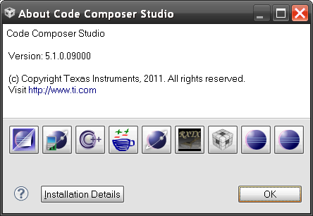

    When I try to start the CCS5  web setup (ccs_setup_5.1.0.09000.exe) it tells me:
    But my installed CCS version matches:
    Christian

  • Hi Christian,
    It looks like you installed a newer version of spectrum digital over the initial CCS installation. Unfortunately, the 5.1.0 version doesn't allow you rerun the installer in that case, to prevent integration issues. 5.1.1 and up does allow it, if the component that's installed necessary to the new ISA being installed.
    In the current case, you would need to reinstall CCS. Sorry for the inconvenience.
