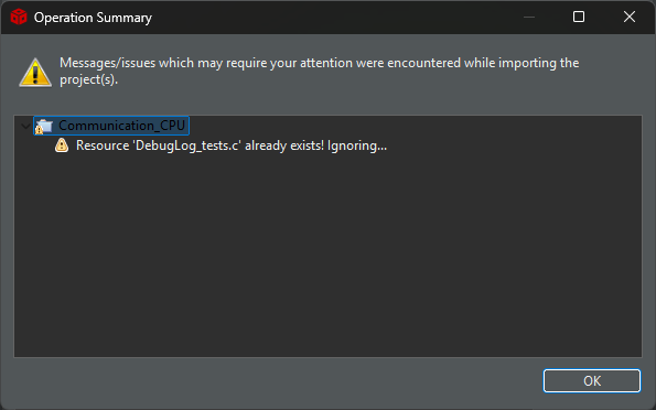

I have a project defined in a projectspec file, where the bulk part of the code is in a few foldres that i include in the project by linking to the folders. using a tag like this:
<file action="link" targetDirectory="Src" targetName="Common" path="COMMONS_SRC_ROOT" createVirtualFolders="true"/>
Inside this folder I have a single file that I want to mark "excluded from build", I do this
            <file action="link" targetDirectory="Src/Common/Tools/test" path="COMMONS_SRC_ROOT/Tools/test/DebugLog_tests.c" excludeFromBuild="true"/>
And this works.
But when importing the project in CSS ig am geeted with this dialog
The reason I claim this to be misleading is that says "Ignoring!", but when i look in the created project, the file is excluded from build.
 So my question here is
  1. Why is this a warning in the first place, there is no conflict in the references?
    I would see it as a warning if I tried to copy a file to a exsisting virtual folder or similar, but not here.
  2. If you keep this as a warning, will you change it to be less misleading?
    I assume the "ignore" claim comes from the your code that wants to create the link, but the code that sets the attribute just runs with no warning. Creating this misleading warning.
  3. Is there any other way to mark the file marked as excluded in the projectspec file. Except for creating links to every single file?
I use CCS 12.80, if this is fixed in Theia, let me know. It would be an argument to upgrade the team.

    Engineering confirmed that the current behavior also exists with CCS Theia.
    Note that engineering mentioned that the warning you described in your first post refers to the request to link the same file twice and not about excluding the file from the build. They provided a solution that would require a modification to the project spec. Add a 'overwriteExisting="true"' attribute to the second <file> element:
    <file action="link" targetDirectory="Src" targetName="Common" path="C:/common_files" createVirtualFolders="true"/>
    <file action="link" targetDirectory="Src/Common" path="C:/common_files/main.c" createVirtualFolders="true" overwriteExisting="true" excludeFromBuild="true"/>
    With this attribute, CCS knows that this is not a mistake, so it does not flag it with a warning.

  • Ah sorry for the lack of update. This should be fixed in the latest release CCS 20.5.0.
    As per engineering:
    In CCS 20.5.0:
    if this user keeps 'overwriteExisting="true"', CCS would no longer delete the original SDK file, and it will show an error notification.
    If the user removes the 'overwriteExisting="true"', then they would see the old warning again
    And to suppress that warning, I added a new field - 'preserveExisting="true"'
