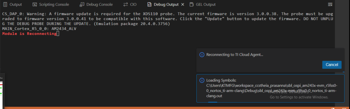

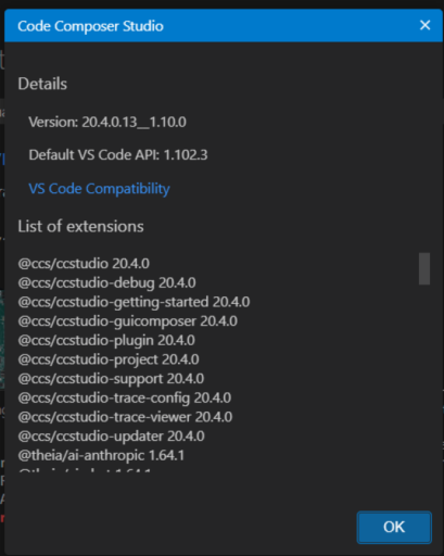

I was prompted to update CCS to the latest and I decided to do the update. There was a package "IDE" and during this installation I ran into few errors and now my debugger is not working anymore. CCS is able to connect to the Target but not able to load symbols.  CCS is hanging at this point forever.
