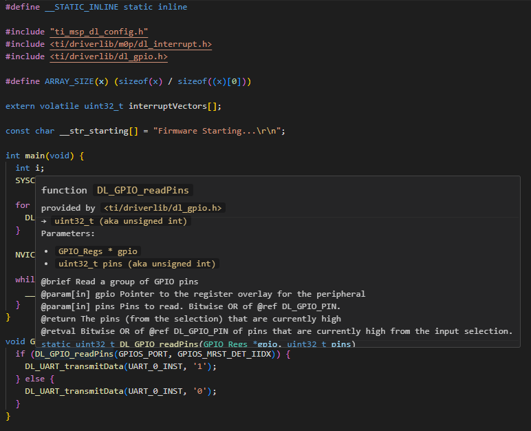

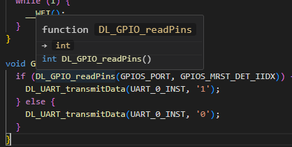

CODECOMPOSER: The "__STATIC_INLINE" macro is not recognized by clangd, thus there is no auto-completion.
Part Number: CODECOMPOSER
Other Parts Discussed in Thread: CCSTUDIO, MSPM0C1104
I have same symptom with this (https://e2e.ti.com/support/tools/code-composer-studio-group/ccs/f/code-composer-studio-forum/1448946/codecomposer-thiea-clangd-fails-to-recognize-some-functions-in-the-same-header)
So I traced what is problem

Project imported / empty_driverlib_src / MSPM0C1104
Here is what I done :
added clangd launch argument --log=verbose
Then I can verify compiler that launched from clangd doesn't recognize __STATIC_INLINE macro

In this state, no auto completion work
my temporary solution is define static inline as __STATIC_INLINE (really needed?) macro top of main.c file
I don't know '__STATIC_INLINE' is 'static inline' but working now
Please fix this

    It seems clangd automatically finds Windows SDK and make driver invocation string including -triple x86_64-pc-windows-msvc19.44.35222 and Windows SDK headers
    seems this causing files not parsed correctly
    How can I prevent this?
    One thing to try is updating the clangd version. People have reported better functionality with a later version.
    See the below post on how to update the version from within CCS:
     RE: CCSTUDIO-THEIA: Updating clang language server i CCS?
