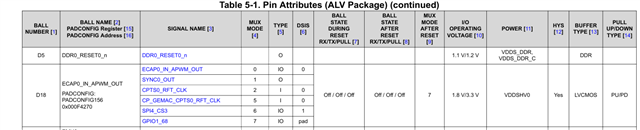

  • Hi Surti,
    Using ECAP, we can able to measure the 25MHZ frequency from Linux kernel ?
    GPIO pin - GPIO1_68
    Based on your inputs from the above thread.
    https://e2e.ti.com/support/processors-group/processors/f/processors-forum/1242640/am625-ecap/4777458?tisearch=e2e-sitesearch&keymatch=am62%2525252520ecap#4777458 (By using this link created a node to capture the ecap )

    k3-am64-main.dtsi
    /* ecap capturemode*/
    	ecap0: capture@23100000 {
    	        compatible = "ti,am62-ecap-capture";
    	        reg = <0x0 0x23100000 0x0 0x100>;    /* capture binding uses 0x100 */
    	        interrupts = <GIC_SPI 113 IRQ_TYPE_EDGE_RISING>; /* <-- REPLACE */
    	        power-domains = <&k3_pds 51 TI_SCI_PD_EXCLUSIVE>; /* <-- REPLACE */
    	        clocks = <&k3_clks 51 0>;                              /* <-- REPLACE */
    	        clock-names = "fck";
    	        status = "okay";
    	        /* Route your FPGA 25 MHz signal to eCAP0_IN */
    	        /* pinctrl-names = "default"; */
    	        /* pinctrl-0 = <&ecap0_in_pins>; */
    k3-am642-evm.dts
    &ecap0 {
    	status = "okay";
    	/* PWM is available on Pin 1 of header J12 */
    	pinctrl-0 = <&main_ecap0_pins_default>;
    pin mux configuration
    main_ecap0_pins_default: main-ecap0-pins-default {
    		pinctrl-single,pins = <
    			AM64X_IOPAD(0x0270, PIN_INPUT, 0) /* (D18) ECAP0_IN_APWM_OUT */

    SoC_FPGA_5 - GPIO1_68 ( PIN DRIVING WITH 25MHZ FROM FPGA)
    I am working on the AM6442 (AM64x family) device and interfacing it with an external FPGA (Artix-7). The FPGA is generating a 25 MHz square wave signal that I need to measure inside the AM6442.
    PRU-ICSS (GPIO pin does not list PRU capability).
    R5F (FreeRTOS or No-RTOS) using ECAP.
    For measuring a 25 MHz external signal, would ECAP on R5F be the recommended approach if PRU routing is not available?
    Provide some examples.

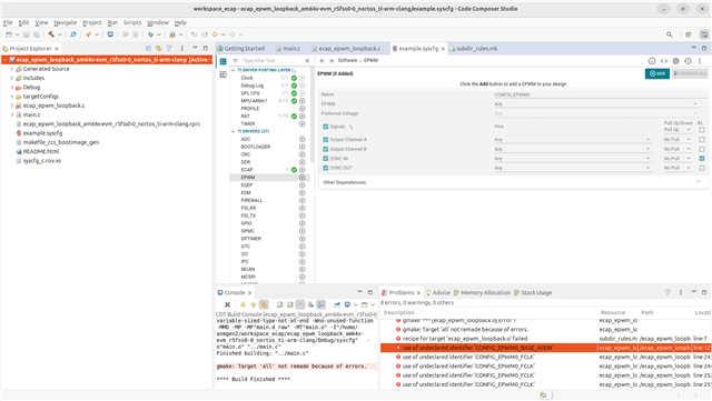

  • Hi Anil,
    Taken example from /ti/mcu_plus_sdk_am64x_10_01_00_32/examples/drivers/ecap/ecap_epwm_loopback/am64x-evm/r5fss0-0_nortos/ to build the ECAP module to read the signal of a GPIO pin.
    1) Removed the EPWM module from the SYSCONFIG file & building the example getting error.

    Building file: "../ecap_epwm_loopback.c"
    Invoking: Arm Compiler
    "/home/asmgen2/ti/ccs1281/ccs/tools/compiler/ti-cgt-armllvm_4.0.2.LTS/bin/tiarmclang" -c -mcpu=cortex-r5 -mfloat-abi=hard -mfpu=vfpv3-d16 -mlittle-endian -mthumb -I"/home/asmgen2/ti/ccs1281/ccs/tools/compiler/ti-cgt-armllvm_4.0.2.LTS/include/c" -I"/home/asmgen2/ti/mcu_plus_sdk_am64x_10_01_00_32/source" -DSOC_AM64X -D_DEBUG_=1 -g -Wall -Wno-gnu-variable-sized-type-not-at-end -Wno-unused-function -MMD -MP -MF"ecap_epwm_loopback.d_raw" -MT"ecap_epwm_loopback.o" -I"/home/asmgen2/workspace_ecap/ecap_epwm_loopback_am64x-evm_r5fss0-0_nortos_ti-arm-clang/Debug/syscfg"   -o"ecap_epwm_loopback.o" "../ecap_epwm_loopback.c"
    subdir_rules.mk:7: recipe for target 'ecap_epwm_loopback.o' failed
    ../ecap_epwm_loopback.c:121:59: error: use of undeclared identifier 'CONFIG_EPWM0_BASE_ADDR'
      121 |     gEpwmBaseAddr = (uint32_t)AddrTranslateP_getLocalAddr(CONFIG_EPWM0_BASE_ADDR);
    ../ecap_epwm_loopback.c:243:42: error: use of undeclared identifier 'CONFIG_EPWM0_FCLK'
      243 |     EPWM_tbTimebaseClkCfg(gEpwmBaseAddr, APP_EPWM_TB_FREQ, CONFIG_EPWM0_FCLK);

    2) How to resolve it?
    Thanks & regards,
    Ravilla Dinesh
  • Hello Ravilla,
    I noticed that you have removed the PWM peripheral initialization from sysconfig, but you are still calling PWM APIs inside your application code.
    This will cause issues because the PWM peripheral is no longer initialized.
    Please remove all PWM API calls from your application code, and it should work correctly.
    Anil.
