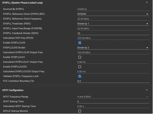

I would like to configure the different clocks with “classic clock tree tool”, so I start with SYSPLL clock, like this:
So it seems correct in comparison to graphic clock tree

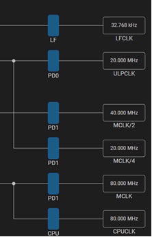

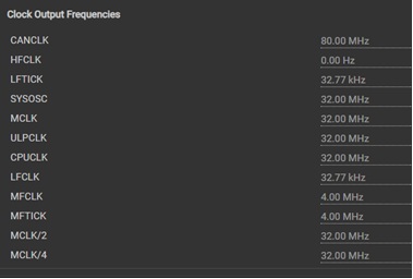

But the frequencies are not the expected
Because I would like this

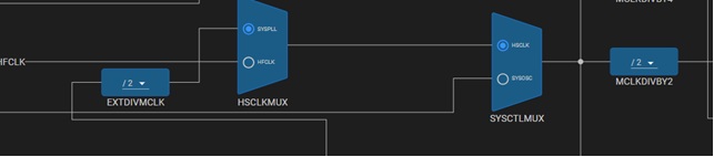

So to obtain this I have to configure this :
But I did not find where “EXTDIVMCLK” and “MCLKDIVBY2” are defined ?
