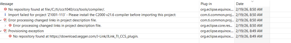

I have a new computer, have the same CCS setup (V10.4) and compiler installed, however it is not possible to import a project from the old computer to the new computer.
Any ideas?
    I see several errors in there. Is the directory structure of both the CCS installation and also the project (and dependent files) set up the same in the new PC vs the old one?
    Looks like the customer updated the compiler version to v21.6. They will need to do the same with their new PC:

    The last error is regarding J-Link update site. Is the customer using J-Link for their debug probe?
    ki
  • Both version and path of CCS, compiler, and project are the same on both PC. Also, I don't use J-Link, the project is setup with Blackhawk emulator. I am puzzled why this message pops up.
    Even though if any path would be different, CCS should give a warning but not prevent me from importing!!
  • You can ignore the J-Link error since it is not applicable for you. You can resolved the compiler version issue by using the update manager to install that particular version. The other errors are odd. Please provide the Eclipse log mentioned in the below link:

  • I think I got my issue resolved. I had installed CCS again, but that didn't fix it. it appears that I didn't pay enough attention where the compiler were installed, and I also hadn't 'registered' them with CCS (never had to do this before).
    I now can import and compile just fine.
    I am still puzzled why CCS would prevent importing a project in this case.

    If the compiler is installed by Resource Explorer or via the CCS Update Manager, then CCS *should* automatically discover it. If it is installed manually outside CCS, then CCS would need to "discover" it first.
    Some projects have a hard dependency on a specific compiler version and not having it can block the import. Older versions of CCS (like 10.x) were also more strict about enforcing this. This behavior was made more lenient in later version where it could import with a warning.
