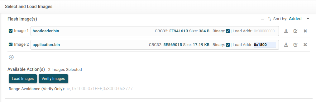

Debug setup
HW: TI XDS110
IDE: CCS 20.4.1
Flasher: uniFlash 9.4.1
Configuration:
    "name": "application",
    "type": "ccs-debug",
    "request": "launch",
    "projectInfo": {
        "resourceId": "/application",
        "loadSymbolsOnly": true
    "connections": [
Testing process
- connecting to running application
1) Application from flash 0x0 without bootloader
    - code works, led is repeatedly blinking
2) Bootloader + dummy_app
    - dummy_app blinks 3 times as in code below
    void SysTick_Delay(uint32_t ticks)
        SysTick->LOAD = ticks - 1;
        SysTick->VAL = 0;
        SysTick->CTRL = 5;  // enable with CPU clock
        while((SysTick->CTRL & (1 << 16)) == 0);
        SysTick->CTRL = 0;
    int main(void)
        SYSCFG_DL_init();
        for (int i = 0; i < 3; i++)
            DL_GPIO_setPins(PA_PORT, PA_LEDR_PIN);
            SysTick_Delay(16000000);
            DL_GPIO_clearPins(PA_PORT, PA_LEDR_PIN);
        while (1) {
    - debug works as intended, after reset I can go through main step by step
3) Bootloader + Application
    - application is stuck in Default_Handler.
    - VTOR is correctly set
    - in flash at 0x1800 is correctly interrupt vector table
Does MSPM0L1105 need to have set / reset something more than I have already done? I tried everything I could think of but I cannot make the application run.
