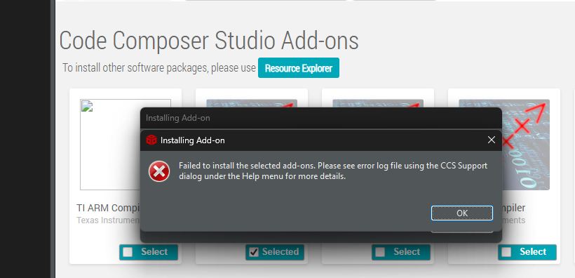

Per an answer on another forum post ((1) TMDS64EVM: First time using TMDS64EVM - Processors forum - Processors - TI E2E support forums ), I am attempting to follow set "Create PRU project from scratch" steps under the AM64x Academy (Creating a CCS PRU Project ), at the bottom of the page. I installed the latest install package of CCS version 12.
In the note in the middle of step 2, I am going to View--> CCS App Center to downloand a missing PRU Compiler before setting up my demo project. When I attempt to install the PRU Compiler, I get the following error message:pru_install_failed.JPG
The error log contents from the failed install is attached. What next steps can I take? I installed CCS 12 over CCS v20 because the interface of v20 changes to such a degree that none of the steps outlined in the PRU Academy information aligned with the application layout, and I couldn't proceed with setting up a project correctly.
error.log
  • Hey there Seth,
    Hmm, interesting error.
    I definitely don't want this to be the default experience for people using the PRU Getting Started Labs. So I will give you options for moving forward, but I will also be thinking about how to prevent future readers from running into the same thing.
    Short term:
    The PRU-CGT can be downloaded from here, and placed in your computer's ~/ti (Linux) or C:\ti (Windows) folder:
    https://www.ti.com/tool/PRU-CGT
    potential firewall issue?
    I wonder if this issue is caused by any network security restrictions on your side, like a firewall blocking HTTPS connection to the TI servers? I am going to send your ticket to the CCS team to get their thoughts as well.

  • Short term:
    I would recommend this option.
    CCS 12.x is no longer supported. Any issues with App Center will not be addressed. That said, I did give this a try and was able to use it to install the PRU compiler without issue. So it could be a proxy issue: https://software-dl.ti.com/ccs/esd/documents/users_guide_12.8.0/ccs_troubleshooting.html#check-the-proxy-setting
    If you are still having issues, manually downloading and installing the compiler is a good option. So is using the update manager.
    Once installed, make sure that it is "discovered": https://dev.ti.com/tirex/explore/node?isTheia=false&node=A__AJRfIGmBSkp9naUDysxAFg__ccs_devtools__FUz-xrs__LATEST
    ki
  • Thank you this worked, I was able to build with the tools on a basic "hello world" project and will reach out on a new ticket if I get stuck when the code complexity grows.
