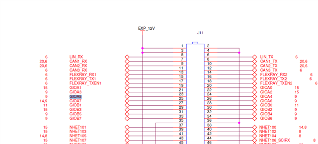

    1) Why does the DClr signal switch to high when I set DSet to high? Aren't these two independent signals?
    Are you measuring your signal at right pin? GIO_A5 is at 23rd pin of J11 connector.
    Make sure to measure at right signal, because i don't see any other reason for wrong waveform. Unfortunately, i don't have this board to test issue at my end.

  • I have verified the connections: Pin 23 (GIOA[5]) and Pin 35 (GND).

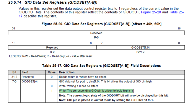

    Could you confirm whether there is a direct relationship where DClr is automatically set to 1 when DSet is set to 1?
    I still don't understand why DClr (which is to clear gio) is changing.
  • Hi Sebastian,
    This is expected behavior only.
    If you verify DClr or DSet register definitions in TRM there you can find a note like below.
    Note: The current logic state of the GIODOUT bit will also be displayed by this bit.
    So, this means DClr and DSet registers also implies the status of GIODOUT that means they will directly imply the status of the output pin.
    That means if you change the pin status the corresponding new status can be read back from these registers as well.
    For example, if you set the output pin to logic high using DSet register, then after that the corresponding output status that is logic high will also reflect on DSet and DClr registers along with DOut register.
    Similarly, if you clear the output pin to logic low using DClr register (writing 1 to the bit), then after that the corresponding output status that is logic low will also reflect on DSet and DClr registers along with DOut register.
    So, this behavior of DSet and DClr is not the issue, the root cause should be something else, some hardware issue. I am suspecting there should be some short between pin with GND. So this is the reason even if we write logic high it is slowly pulling to logic low.
