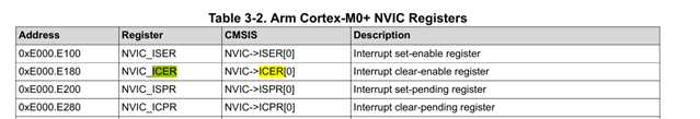

I implemented a custom bootloader for the MSPM0L1306. The bootloader loads the main application into flash and then jumps to it. So the processor starts at 0x0000 inside the bootloader and the bootloader jumps on valid application code into the application.
The jump itself appears to work, but the application immediately ends up in the Default_Handler.
According to the map file of the main application, the vector table is located at 0x00003100.

  __disable_irq();
  // Disable all interrupts
  for (int i = 0; i < 8; i++) {
    NVIC->ICER[i] = 0xFFFFFFFF;
    NVIC->ICPR[i] = 0xFFFFFFFF;

  SCB->VTOR = APP_START_ADDRESS;
  __DSB();
  __ISB();
  // Set stack pointer
  __set_MSP(appStack);
  // Jump to reset handler
  ((void (*)(void))appReset)();

My questions:
  1. Is this the correct procedure to jump from a bootloader to an application on MSPM0 devices?
  2. Are there additional steps required when switching the vector table (SCB->VTOR)?
  3. Could this behavior be related to the linker configuration or the startup code of the application?
