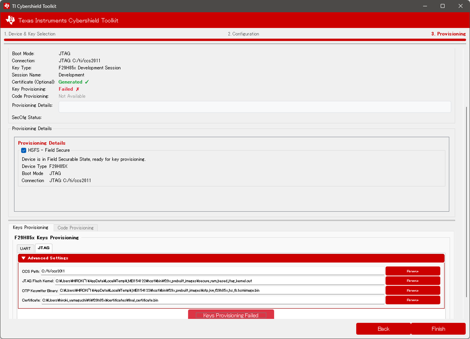

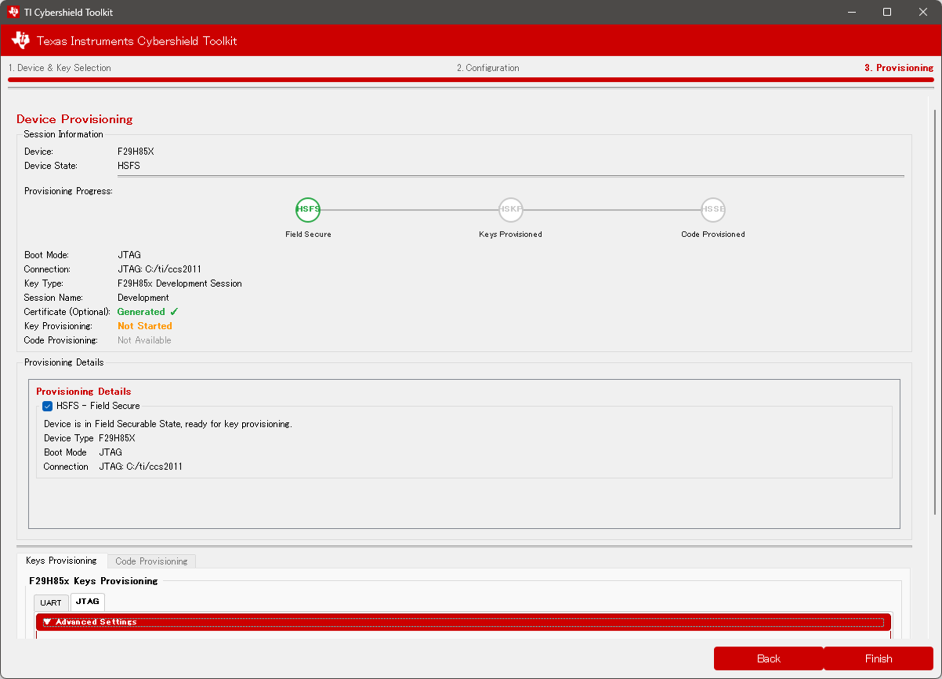

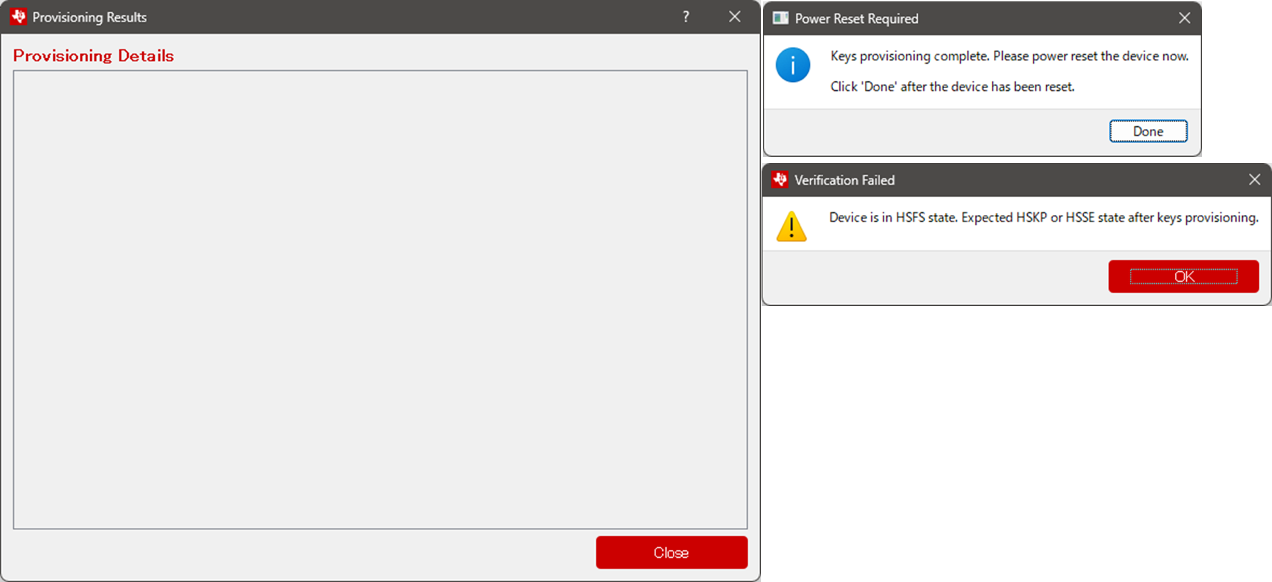

The “F29H85x Keys Provisioning” process fails.
What do you think could be the cause?
We have attached screenshots of the tool and the log files.
Also, is there a user guide or documentation for the Cybershield Kit Tool?

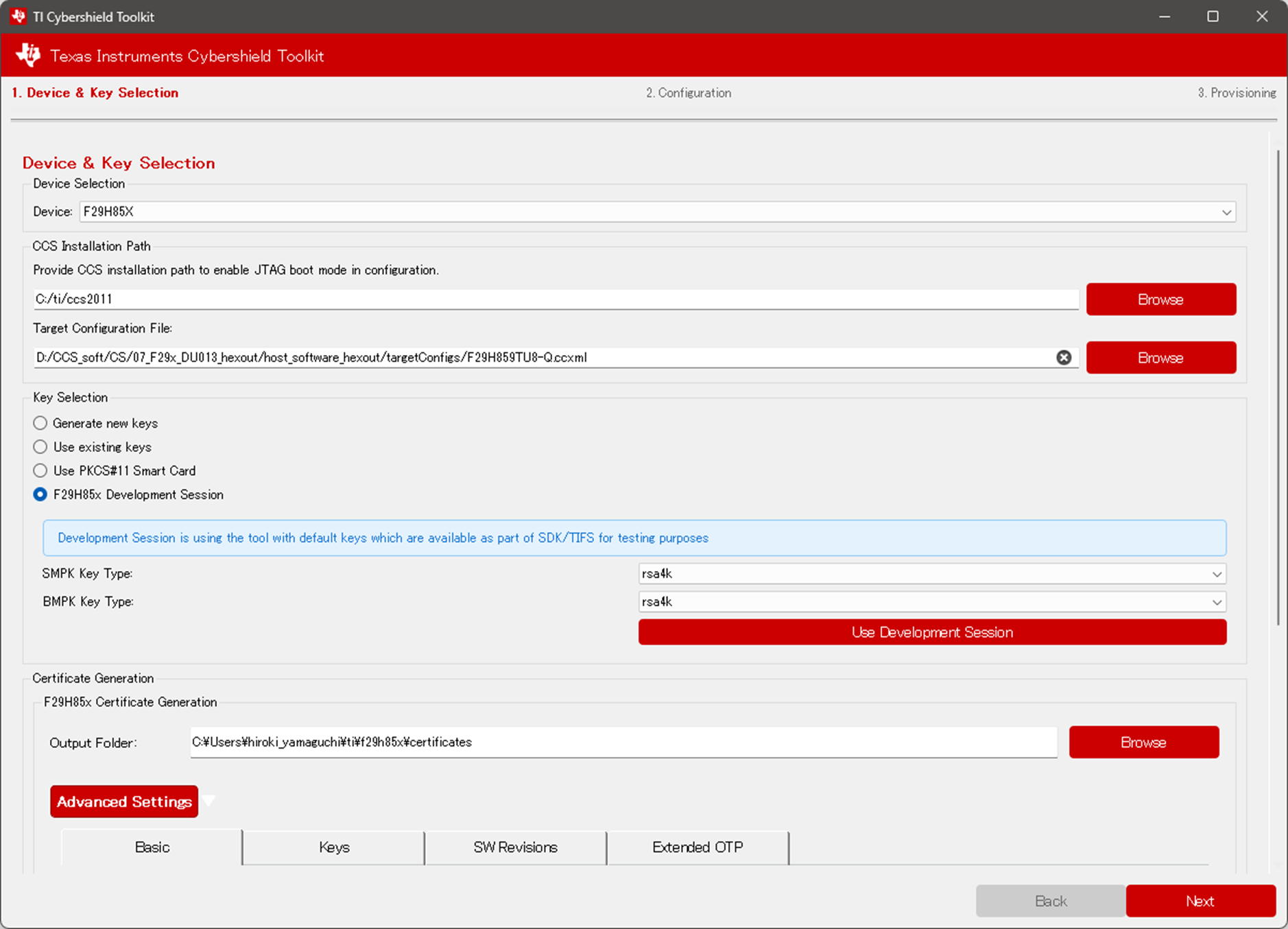

Starting TI Cybershield Toolkit Wizard...
Device changed to: F29H85X
Setting up F29 development session with data: {'smpk_algo': 'rsa4k', 'bmpk_algo': 'rsa4k', 'type': 'f29_development'}
Generate F29 certificate: {'device': 'f29h85x', 'msv': '0x1E22D', 'flags': ['msv_protect', 's_protect', 'smek_protect', 'b_protect', 'bmek_protect', 'keycnt_protect', 'smpk', 'smek', 'bmpk', 'bmek'], 'output_dir_path': 'C:\\Users\\hiroki_yamaguchi\\ti\\f29h85x\\certificates', 'pub_key_path': 'C:/ti/otp_keywriter_f29h85x_SR_10_1_01_00/sbl_keywriter/scripts/cert_gen/common/tifek/f29h85x/SR_10/ti_fek_public.pem', 'dev_sr_ver': 'SR_10', 'keycnt': '2', 'keyrev': '1', 'sr_sbl': '1', 'sr_hsmRT': '1', 'sr_app': '1', 'sr_ssu': '1', 'ext_otp': '0x80000001', 'ext_otp_indx': '0', 'ext_otp_size': '32', 'smpk_signing_algorithm': 'rsa4k', 'bmpk_signing_algorithm': 'rsa4k'}
Generating certificate with data: {'device': 'f29h85x', 'msv': '0x1E22D', 'flags': ['msv_protect', 's_protect', 'smek_protect', 'b_protect', 'bmek_protect', 'keycnt_protect', 'smpk', 'smek', 'bmpk', 'bmek'], 'output_dir_path': 'C:\\Users\\hiroki_yamaguchi\\ti\\f29h85x\\certificates', 'pub_key_path': 'C:/ti/otp_keywriter_f29h85x_SR_10_1_01_00/sbl_keywriter/scripts/cert_gen/common/tifek/f29h85x/SR_10/ti_fek_public.pem', 'dev_sr_ver': 'SR_10', 'keycnt': '2', 'keyrev': '1', 'sr_sbl': '1', 'sr_hsmRT': '1', 'sr_app': '1', 'sr_ssu': '1', 'ext_otp': '0x80000001', 'ext_otp_indx': '0', 'ext_otp_size': '32', 'smpk_signing_algorithm': 'rsa4k', 'bmpk_signing_algorithm': 'rsa4k'}
Using development session mode
DEBUG: F29 certificate generation command: script_name --device f29h85x --smpk_signing_algorithm rsa4k --bmpk_signing_algorithm rsa4k gencert -t C:/ti/otp_keywriter_f29h85x_SR_10_1_01_00/sbl_keywriter/scripts/cert_gen/common/tifek/f29h85x/SR_10/ti_fek_public.pem --msv 0x1E22D --msv_protect --bmpk --bmek --b_protect --bmek_protect --smpk --smek --s_protect --smek_protect --sr_sbl 1 --sr_hsmRT 1 --sr_app 1 --sr_ssu 1 --keycnt 2 --keycnt_protect --keyrev 1 -d f29h85x --devSrVer SR_10 --ext_otp 0x80000001 --ext_otp_indx 0 --ext_otp_size 32

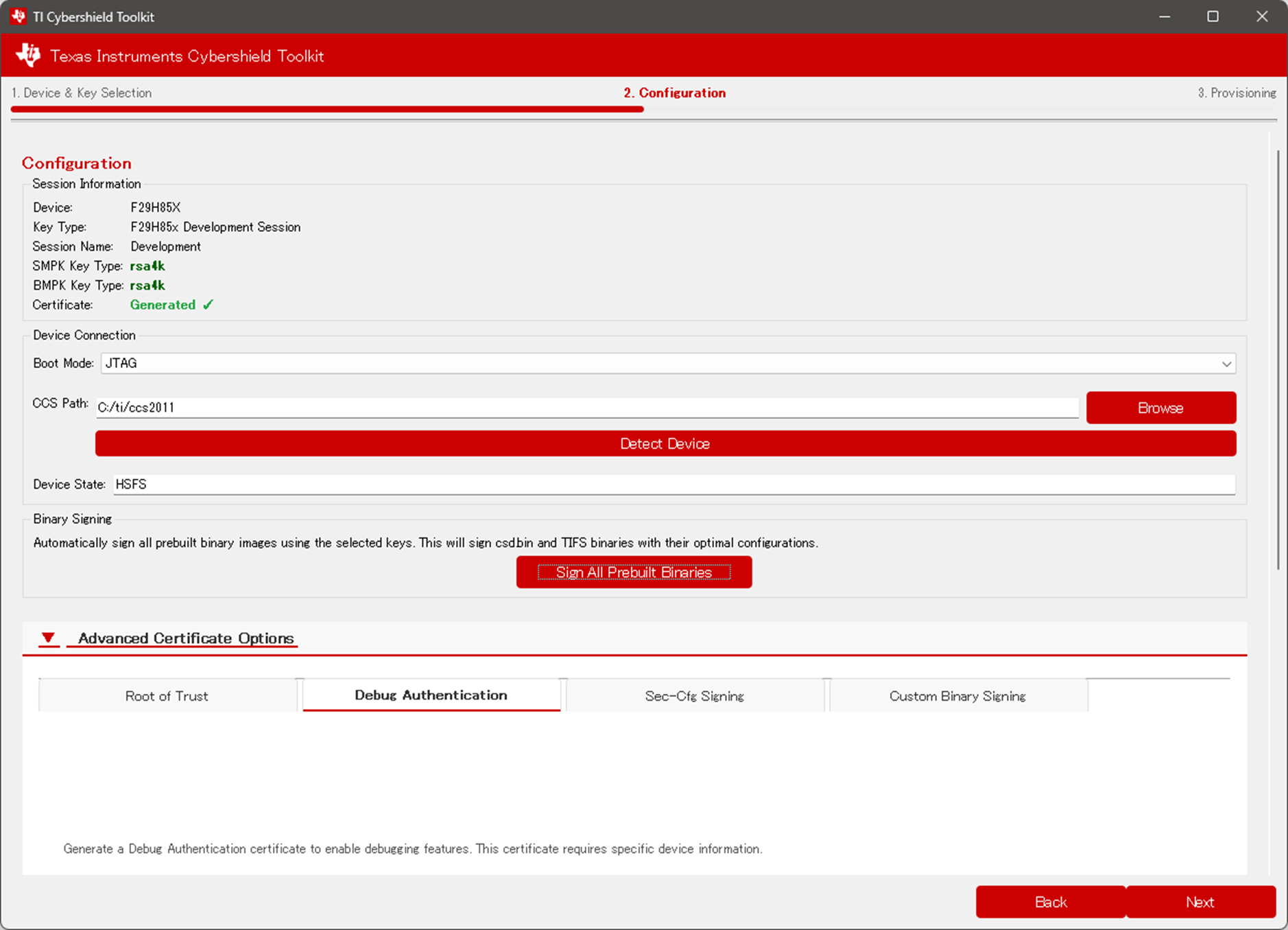

DEBUG: Signing specific F29H85x binaries: ['ram_based_uart_sbl.bin', 'tifs_f29h85x_hs_se_code_provisioning.release.bin']
DEBUG: F29H85x specific binary signing requested
DEBUG: Using session: Development
DEBUG: Development session with SMPK: rsa4k, BMPK: rsa4k
DEBUG: Using prebuilt images directory: C:\Users\HIROKI~1\AppData\Local\Temp\_MEI154122\host\bin\f29x_prebuilt_images

Detecting device with boot mode: JTAG, connection info: {'type': 'jtag', 'ccs_path': 'C:/ti/ccs2011'}
Error during JTAG detection: 'F29H85xDeviceModel' object has no attribute 'run_command'
2026-03-30 16:59:02,530 - apps.tifs.kp_cp_f29h85x.jtag_provisioning - INFO - Running Get Device Type command: C:/ti/ccs2011\ccs\scripting\run.bat C:\Users\HIROKI~1\AppData\Local\Temp\_MEI154122\apps\tifs\kp_cp_f29h85x\read_lifecycle.js
2026-03-30 16:59:02,533 - apps.tifs.kp_cp_f29h85x.jtag_provisioning - INFO - Using CCXML path: C:\Users\HIROKI~1\AppData\Local\Temp\_MEI154122\host\src\apps\tifs\kp_cp_f29h85x\F29h85x-hsse.ccxml
2026-03-30 16:59:11,121 - apps.tifs.kp_cp_f29h85x.jtag_provisioning - INFO - Command output:
Device is in HS_FS state
2026-03-30 16:59:11,122 - apps.tifs.kp_cp_f29h85x.jtag_provisioning - INFO - Get Device Type completed successfully

2026-03-30 17:00:34,690 - apps.tifs.kp_cp_f29h85x.jtag_provisioning - INFO - Running key provisioning with command: C:/ti/ccs2011\ccs\scripting\run.bat C:\Users\HIROKI~1\AppData\Local\Temp\_MEI154122\apps\tifs\kp_cp_f29h85x\run_keyprov_flow.js --otp-kw-bin C:\Users\HIROKI~1\AppData\Local\Temp\_MEI154122\host\bin\f29x_prebuilt_images\otp_kw_f29h85x_hs_fs.hsmimage.bin --certificate C:\Users\hiroki_yamaguchi\ti\f29h85x\certificates\final_certificate.bin --jtag-kernel C:\Users\HIROKI~1\AppData\Local\Temp\_MEI154122\host\bin\f29x_prebuilt_images\secure_ram_based_jtag_kernel.out
2026-03-30 17:00:44,689 - apps.tifs.kp_cp_f29h85x.jtag_provisioning - INFO - Command output:
Loading OTP KW binary from: C:\Users\HIROKI~1\AppData\Local\Temp\_MEI154122\host\bin\f29x_prebuilt_images\otp_kw_f29h85x_hs_fs.hsmimage.bin
Loading certificate from: C:\Users\hiroki_yamaguchi\ti\f29h85x\certificates\final_certificate.bin
Loading JTAG flash kernel from: C:\Users\HIROKI~1\AppData\Local\Temp\_MEI154122\host\bin\f29x_prebuilt_images\secure_ram_based_jtag_kernel.out
Expecting target to not halt for 10 seconds
Log file contents:
2026-03-30 17:00:44,689 - apps.tifs.kp_cp_f29h85x.jtag_provisioning - WARNING - Command errors:
Failure: Halted unexpectedly after removing both breakpoints.
2026-03-30 17:00:44,690 - apps.tifs.kp_cp_f29h85x.jtag_provisioning - INFO - Key provisioning completed successfully
2026-03-30 17:00:44,693 - apps.qtgui.utils.log_parser - WARNING - Could not find repository base, using current directory
2026-03-30 17:01:14,522 - apps.tifs.kp_cp_f29h85x.jtag_provisioning - INFO - Running Get Device Type command: C:/ti/ccs2011\ccs\scripting\run.bat C:\Users\HIROKI~1\AppData\Local\Temp\_MEI154122\apps\tifs\kp_cp_f29h85x\read_lifecycle.js
2026-03-30 17:01:17,524 - apps.tifs.kp_cp_f29h85x.jtag_provisioning - INFO - Command output:
2026-03-30 17:01:17,524 - apps.tifs.kp_cp_f29h85x.jtag_provisioning - INFO - Get Device Type completed successfully
