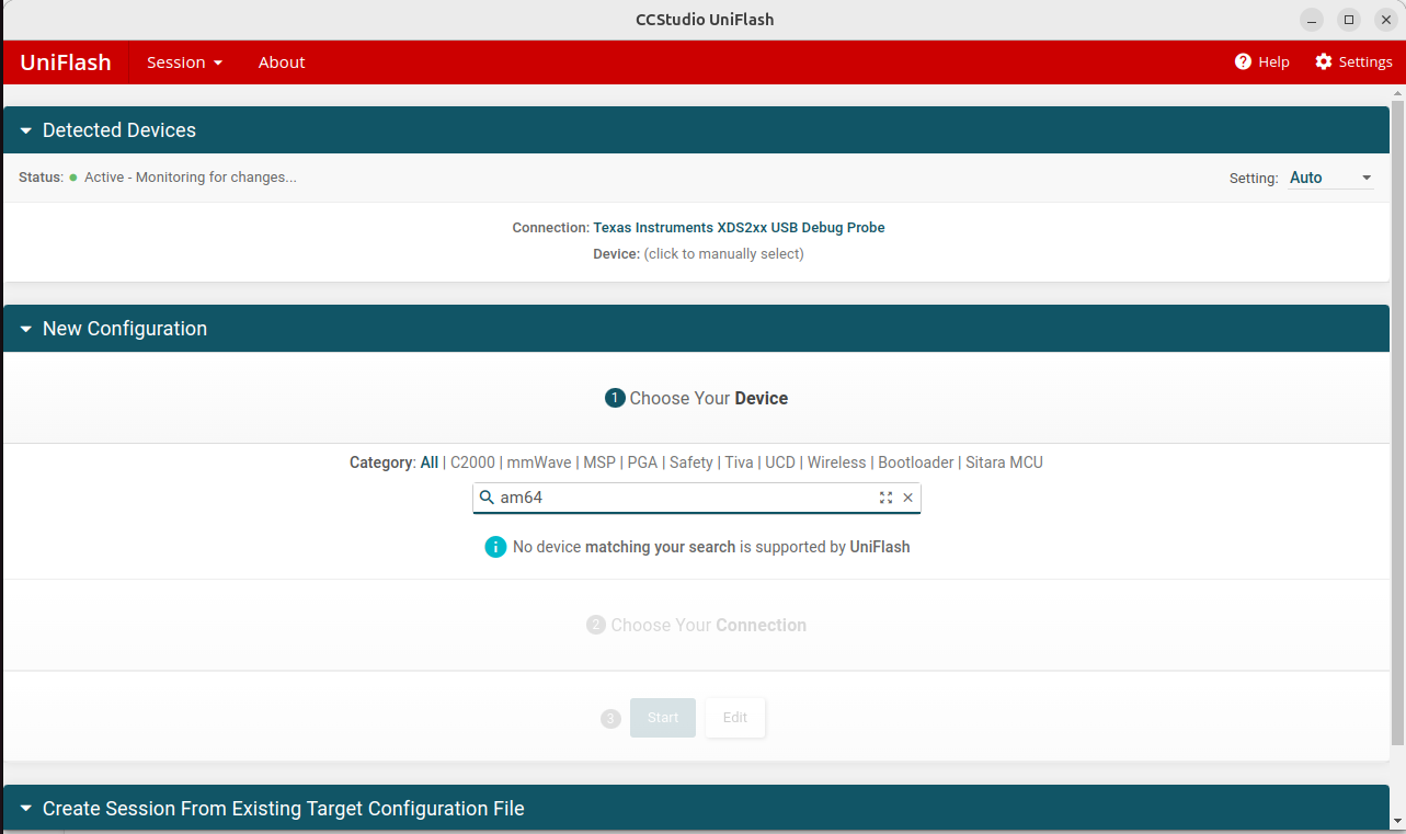

Hi Team,
Why AM64x Doesn’t Show in UniFlash GUI?
I am working with the AM6442 EVM and need guidance on flashing my application to the R5F0_0 core.

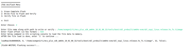

    On CCS debug option the console prints are visible in CCS window, But while doing ospi flashing process we are not getting any terminal prints and don't know how to validate.
    JTAG Uniflash Menu -> sbl_ospi_linux.release.hs_fs.tiimage boot from OSPI.
    JTAG Uniflash Menu -> benchmark_demo_am64x-evm.appimage user build application.
    [FLASH WRITER] Application exited !!! All tests have passed!!

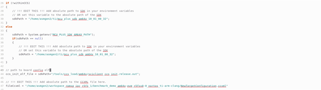

    I think a few steps might be missing in your flow. Let me outline the complete procedure to avoid the issue:
    1. Connect the target configuration in CCS.
    2. If you are using Linux, update the path in:
      load_dmsc_hsfs.js
    3. Ensure the board is in Dev Boot Mode.
    4. Run the DMSC load script (for HS-FS device):
      loadJSFile "home/user/ti/mcu_plus_sdk_{soc}_{sdk version}/tools/ccs_load/am64x/load_dmsc_hsfs.js" (HS-FS device)

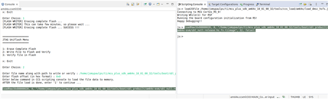

  • Hi JOMY,
    1) Connect the target configuration in CCS.
    2) If you are using Linux, update the path in:
    updated the paths.
    3)Ensure the board is in Dev Boot Mode.
    Dev boot mode only.

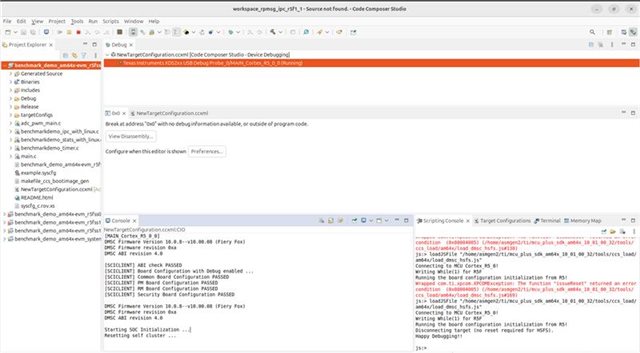

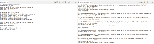

    4)Run the DMSC load script (for HS-FS device):
    js:> loadJSFile "/home/asmgen2/ti/mcu_plus_sdk_am64x_10_01_00_32/tools/ccs_load/am64x/load_dmsc_hsfs.js"
    Connecting to MCU Cortex_R5_0!
    Writing While(1) for R5F
    Running the board configuration initialization from R5!
    Disconnecting target (no reset required for HSFS).
    Happy Debugging!!
    5) In CCS:
    • Go to Run → Load → Load Program
    • Load the SBL JTAG binary: /home/asmgen2/ti/mcu_plus_sdk_am64x_10_01_00_32/examples/drivers/boot/sbl_jtag_uniflash/am64x-evm/r5fss0-0_nortos/ti-arm-clang/sbl_jtag_uniflash.debug.out
    6) Run the code.
     JTAG Uniflash Menu
     1: Erase Complete Flash
     2: Write File to Flash and Verify
     3: Verify file in Flash
     x: Exit
    7)select the 1st option to erase the flash.
    Enter Choice: 1
     [FLASH WRITER] Erasing complete flash ...
     [FLASH WRITER] This can take few minutes, so please wait ...
     [FLASH WRITER] Erasing complete flash ... SUCCESS !!!
    8)Select the second option and provide the path to the prebuilt .tiimage (boot image) with offset 0x0
    /home/asmgen2/ti/mcu_plus_sdk_am64x_10_01_00_32/tools/boot/sbl_prebuilt/am64x-evm/sbl_ospi.debug.hs_fs.tiimage
    9 & 10)The console will generate a CMD—run that in scripting console & Type 1 to continue .
    Enter file name along with path to write or verify :
     Enter flash offset (in hex format) : 0x0
     Enter below command in CCS scripting console to load the file data to memory.
     AFTER the file load is done, enter '1' to continue ...
     loadRaw(0x80000020, 0, "/home/asmgen2/ti/mcu_plus_sdk_am64x_10_01_00_32/tools/boot/sbl_prebuilt/am64x-evm/sbl_ospi.debug.hs_fs.tiimage", 32, false);
    1
     [FLASH WRITER] Flashing success!!...
    11) Use the third option to verify the flashed contents.
    [FLASH WRITER] Verifying success!!...
    12)Change boot mode to OSPI Boot Mode (xspi).
    changed boot mode. (sw2- 11001111 sw3-01000000 )

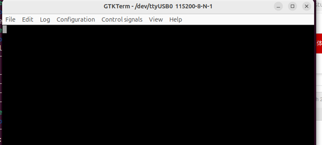

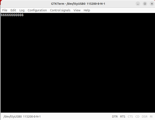

    13 & 14) Power cycle the EVM. & Check the UART output on the dedicated port (dev/ttyUSB0).
    After changing the boot mode to OSPI it's not booting up.
    So, we tried with linux.tiimage also.
    /home/asmgen2/ti/mcu_plus_sdk_am64x_10_01_00_32/tools/boot/sbl_prebuilt/am64x-evm/sbl_ospi_linux.debug.hs_fs.tiimage
    same progress.
    Thanks & Regards,
    Ravilla Dinesh.

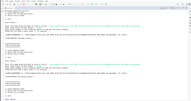

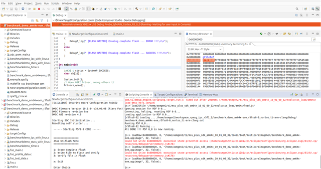

    where to load my application benchmark_demo_am64x-evm_r5fss0-0_nortos_ti-arm-clang.out file?
    I have flashed my application benchmark_demo_am64x-evm_r5fss0-0_nortos_ti-arm-clang.out to the flash.
    For reference:-
     JTAG Uniflash Menu
     x: Exit
     Enter Choice: 2
     Enter file name along with path to write or verify : /home/asmgen2/workspace_rpmsg_ipc_r5f1_1/benchmark_demo_am64x-evm_r5fss0-0_nortos_ti-arm-clang/Debug/benchmark_demo_am64x-evm_r5fss0-0_nortos_ti-arm-clang.out
     Enter flash offset (in hex format) : 0x080000
     loadRaw(0x80000020, 0, "/home/asmgen2/workspace_rpmsg_ipc_r5f1_1/benchmark_demo_am64x-evm_r5fss0-0_nortos_ti-arm-clang/Debug/benchmark_demo_am64x-evm_r5fss0-0_nortos_ti-arm-clang.out", 32, false);
    1
     JTAG Uniflash Menu
     x: Exit
     Enter Choice: 3
    1

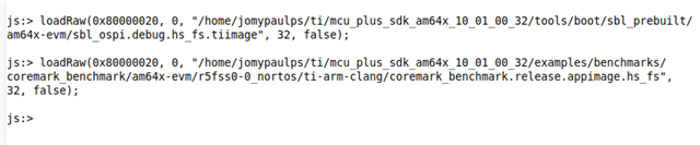

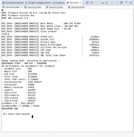

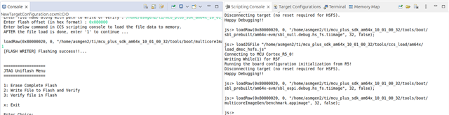

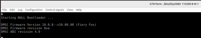

  • Hi Dinesh,
    In the 9th step, have you executed this script in the scripting console?
    I’m sharing the actual output :
    Step 9:
    Step 14:
    you can flash the appimage on top of the bootloader accordingly.

    1) Flashed the image NULL sbl file : /home/asmgen2/ti/mcu_plus_sdk_am64x_10_01_00_32/tools/boot/sbl_prebuilt/am64x-evm/sbl_null.debug.hs_fs.tiimage
    From terminal /dev/ttyUSB0 prints :
    2) Flashed the image :
    OSPI sbl image : /home/asmgen2/ti/mcu_plus_sdk_am64x_10_01_00_32/tools/boot/sbl_prebuilt/am64x-evm/sbl_ospi.debug.hs_fs.tiimage
    Enter file name along with path to write or verify : /home/asmgen2/ti/mcu_plus_sdk_am64x_10_01_00_32/tools/boot/sbl_prebuilt/am64x-evm/sbl_ospi.debug.hs_fs.tiimage
    application : /home/asmgen2/ti/mcu_plus_sdk_am64x_10_01_00_32/tools/boot/multicoreImageGen/benchmark.appimage
    Enter file name along with path to write or verify : /home/asmgen2/ti/mcu_plus_sdk_am64x_10_01_00_32/tools/boot/multicoreImageGen/benchmark.appimage
    5) OSPI flash memory checking through SD card booting and stopped at u-boot & checking the particular address where my application file was sitting inside the memory.
    Application invoke is not happening through OSPI booting.
    How to invoke?

  • Hi Dinesh,
    Good to know you finally got the UART logs.
    From the /dev/ttyUSB0 terminal output, the CPU initialization logs are not showing and the boot process seems to be failing.
    Could you please try this with the latest SDK (11.02.00.24)
    How to invoke?
    Once the initialization is completed, it should jump to the AppImage.

  • Hi JOMY,
    DMSC Firmware Version 10.0.8--v10.00.08 (Fiery Fox)
    DMSC Firmware revision 0xa
    DMSC ABI revision 4.0
    Some tests have failed!!
    Loading the OSPI sbl image :
    /home/asmgen2/ti/mcu_plus_sdk_am64x_10_01_00_32/tools/boot/sbl_prebuilt/am64x-evm/sbl_ospi.debug.hs_fs.tiimage  to boot the R5F0_0 independently from OSPI memory.
    Please give me some inputs to work on it.
    Either my application will in which format:
    (or)
    benchmark_demo_am64x-evm_r5fss0-0_nortos_ti-arm-clang.appimage.hs_fs
    Thanks & regards,
    Ravilla Dinesh.
  • Hi JOMY,
    CCS console:
    script console : loadJSFile "/home/asmgen2/ti/mcu_plus_sdk_am64x_11_02_00_24/tools/ccs_load/am64x/load_dmsc_hsfs.js"
    [MAIN_Cortex_R5_0_0]
    DMSC Firmware Version 11.0.6--v11.00.06 (Fancy Rat)
    DMSC Firmware revision 0xb
    [SCICLIENT] ABI check PASSED
    [SCICLIENT] Board Configuration with Debug enabled ...
    [SCICLIENT] Common Board Configuration PASSED
    [SCICLIENT] PM Board Configuration PASSED
    [SCICLIENT] RM Board Configuration PASSED
    [SCICLIENT] Security Board Configuration PASSED
    Starting SOC Initialization ...
    Resetting self cluster ...
    In CCS:
    • Load the SBL JTAG binary: /home/asmgen2/ti/mcu_plus_sdk_am64x_11_02_00_24/examples/drivers/boot/sbl_jtag_uniflash/am64x-evm/r5fss0-0_nortos/ti-arm-clang/sbl_jtag_uniflash.debug.out
     JTAG Uniflash Menu
     x: Exit
     Enter Choice: 2
     Enter file name along with path to write or verify : /home/asmgen2/ti/mcu_plus_sdk_am64x_11_02_00_24/tools/boot/sbl_prebuilt/am64x-evm/sbl_ospi.debug.hs_fs.tiimage
     loadRaw(0x80000020, 0, "/home/asmgen2/ti/mcu_plus_sdk_am64x_11_02_00_24/tools/boot/sbl_prebuilt/am64x-evm/sbl_ospi.debug.hs_fs.tiimage", 32, false);
    1
     JTAG Uniflash Menu
     x: Exit
     Enter Choice: 2
     Enter file name along with path to write or verify : /home/asmgen2/ti/mcu_plus_sdk_am64x_11_02_00_24/tools/boot/multicoreImageGen/benchmark.appimage
     Enter flash offset (in hex format) : 0x80000
     loadRaw(0x80000020, 0, "/home/asmgen2/ti/mcu_plus_sdk_am64x_11_02_00_24/tools/boot/multicoreImageGen/benchmark.appimage", 32, false);
    1

    Flashing this image (.appimage.hs_fs) :
    1) /home/asmgen2/ti/mcu_plus_sdk_am64x_11_02_00_24/tools/boot/sbl_prebuilt/am64x-evm/sbl_ospi.debug.hs_fs.tiimage. offset - 0x0
    2) /home/asmgen2/workspace_11sdk_ipc/benchmark_demo_am64x-evm_r5fss0-0_nortos_ti-arm-clang/Debug/benchmark_demo_am64x-evm_r5fss0-0_nortos_ti-arm-clang.appimage.hs_fs. offset - 0x80000
    DMSC Firmware Version 11.2.5--v11.02.05 (Fancy Rat)
    KPI_DATA: [BOOTLOADER_PROFILE] CPU Clock        : 800.000 MHz
    KPI_DATA: [BOOTLOADER_PROFILE] Boot Media       : NOR SPI FLASH
    KPI_DATA: [BOOTLOADER_PROFILE] Boot Media Clock : 166.667 MHz
    KPI_DATA: [BOOTLOADER_PROFILE] Boot Image Size  : 103 KB
    KPI_DATA: [BOOTLOADER_PROFILE] Cores present    :
    r5f0-0
    KPI_DATA: [BOOTLOADER PROFILE] SYSFW init                       :      11316us
    KPI_DATA: [BOOTLOADER PROFILE] System_init                      :     363236us
    KPI_DATA: [BOOTLOADER PROFILE] Drivers_open                     :       1699us
    KPI_DATA: [BOOTLOADER PROFILE] Board_driversOpen                :    1039533us
    KPI_DATA: [BOOTLOADER PROFILE] Sciclient Get Version            :       9999us
    KPI_DATA: [BOOTLOADER PROFILE] CPU Load                         :      33718us
    KPI_DATA: [BOOTLOADER PROFILE] SBL End                          :       2226us
    KPI_DATA: [BOOTLOADER_PROFILE] SBL Total Time Taken             :    1461728us
    Image loading done, switching to application ...
    Booting has started, but the application prints are not visible. Please test with some example code to verify whether the prints appear and share the results.
    Thanks & regards,
    Ravilla Dinesh.
  • Hi Dinesh,
    Good to know you successfully completed the boot process.
    For the example, you can use
    mcu_plus_sdk_am64x_10_01_00_32/examples/benchmarks/coremark_benchmark/am64x-evm/r5fss0-0_nortos/ti-arm-clang/coremark_benchmark.release.appimage.hs_fs as the appimage (it includes UART prints).
    JOMY
