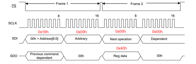

    Checking the waveform that you previously sent, it looks like the SPI mode is now correct.  However, I still think this may be a hardware issue.  Please capture a read transaction from one of the registers.  Register CH0_GAN_MSB address 16 should read back 0x40h after reset.  This will be two 16b frames, as shown below:
    This will allow us to confirm the SPI command is correct, and if we do not receive 0x40h, then the ADC is not responding correctly.

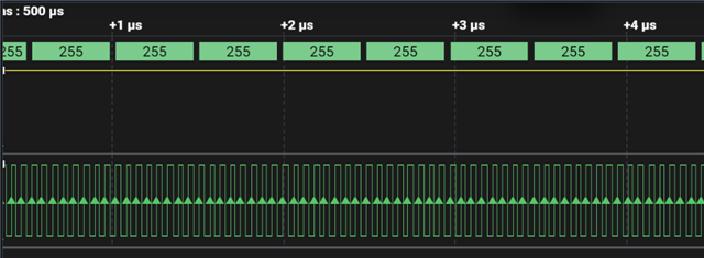

  • Hello! Yes we are using a voltage translator (TXB-EVM). We were able to confirm SPI is functioning via a logic analyzer (as it matches the image you provided), however the watch variable is still not updating correctly, is the logic analyzer enough to prove SPI works correctly? Now the main issue is the data lane, DCLK(PA12) and DOUT0(PB17) pins of the ADC. The MCU in the data lane acts as a peripheral taking in the data from the controller, the ADC. In the code I have disabled the previously enabled +/- FS test, thus expecting low/near 0 values since there is no input to our ADC. However when observed from the logic analyzer we see random values, with consistent 255 values. Since the MCU is the peripheral we have it set to SPI mode 0 and capture on rising edge. I have uploaded photos in the github that show the successful SPI and the unexpected data lane values. Additionally I had the voltage translator connections verified by a TI employee.

    Yes, it does appear the SPI is now working correctly.  If you want to fully exercise the SPI configuration, you can write a value to any of the offset registers, and then immediately read the value back.  For example:
    Write 0xA5 to register 0x16 and then read it back.  This will be 3 SPI frames, with the following MOSI data:
    0x96A5, write register 0x16 command, register data 0xA5
    0x1600, read register 0x16 command
    0x0000, read register contents

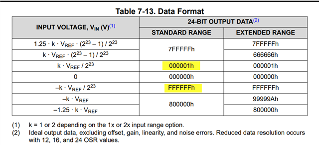

    With the ADS127L18EVM input channels floating, the results should be near 0V, with some noise.  Keep in mind that the output codes can change quite a bit, since small positive values will be near 0x000000h and small negative values will be near 0xFFFFFF due to the two's complement coding of the data.
    The data captured on the DCLK and DOUT lines looks correct.  It does appear that the analyzer is off by 1 clock cycle, but this could be due to your trigger setting.  When capturing the data using the logic analyzer, you should use the FSYNC signal as the SPI chip select and trigger on the FSYNC rising edge.  This will then allow the logic analyzer to correctly interpret the incoming data.  In addition, you can easily tell when a new data conversion cycle begins with each rising edge of FSYNC.
    Once all channels have been transmitted (24*8=192 DCLK's for 8 channels), the remaining data in a data port frame will be all 1's, or high, when using the ADS127L18EVM.  This is because of the 'daisy-chain' behavior of the data port; once all channel data has been transmitted, then whatever data is on the DINx pin is read and passed through.  In the case of the ADS127L18EVM, the DINx pins are pulled high, and thus 0xFF for all remaining data in a data port frame.
    Based on what you have provided, I think the hardware is now working correctly, including the SPI configuration.  You should be able to capture 512 samples of 24b data over 8 channels using the default settings in the code.
