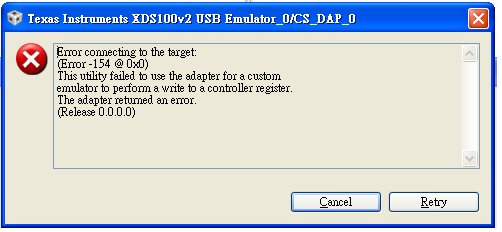

I used XDS100v2 board connecting to LM4F232H5QD Evaluation Board
When debugging , it is show below error message
Please help to provide solutions

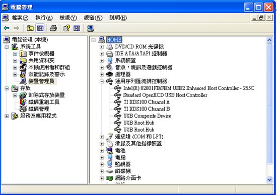

Hi Jonathan,
Do you see any issues in your device manager? What version of CCS are you using? How are you connecting the XDS100? How are you powering? What is your target configuration setup? (.ccxml file with the project)?

I don't see any issue.(As follows)

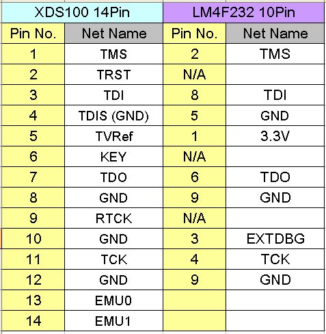

Connection XDS100 and LM4F232 of, the following table.

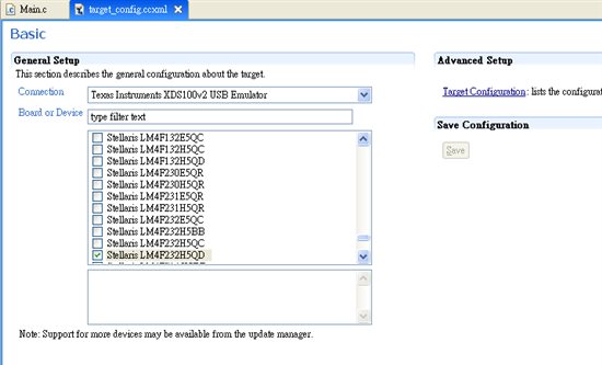

I used Target configuration as follows
