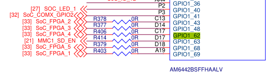

However, on my custom board, only a limited number of pins are routed out, and no EPWM0 to EPWM8 pins are physically available.

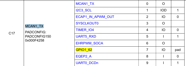

  • I need to use EHRPWM_SOCA.
  • The signal frequency requirement is ~40 MHz
  • I initially expected to drive this as a pin signal, similar to EPWM outputs
custom board pins:

    Please check if you can use SYSCLKOUT0 on the same pin (Mux 3), which will output a clean PLL derived clock.
    Vinu

  • Hi Ravilla,
    SYSCLKOUT0 is not an ePWM pin.
    As mentioned, please configure it with a PLL derived clock.

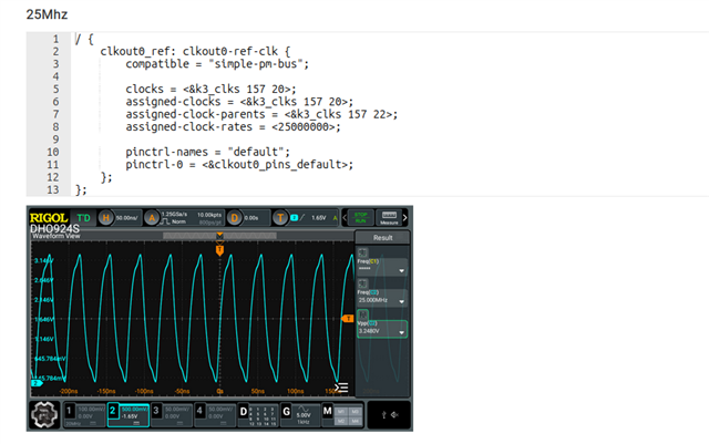

    Please refer  AM625: 50MHz output from CLKOUT0 for a similar issue.
    Vinu

  • Hi Ravilla,
    Give some example configuration for reference for am6442(k3-am642-evm.dts).
    Please refer the AM625 thread that I've shared earlier, just change the parent clock and pin control. (AM625: 50MHz output from CLKOUT0 )
    But keep in mind that you could get either 50Mhz or 25Mhz, not 40Mhz.

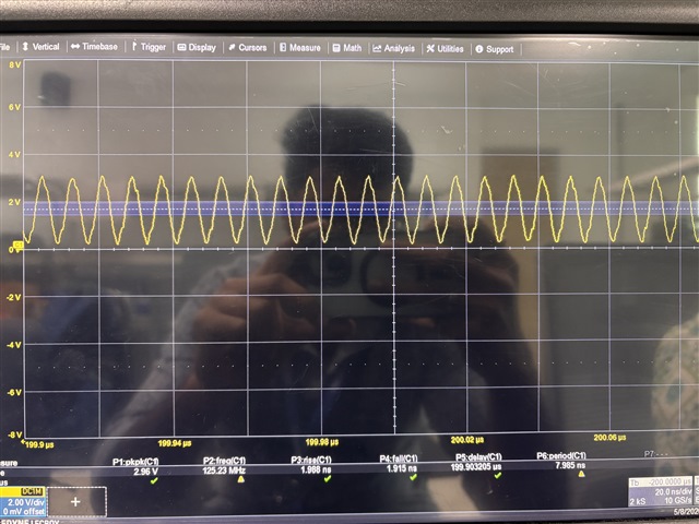

    • But physical output remains fixed at ~125 MHz
    • Parent clock used: clk:125:2
    Issue:
    However, when probing the SYSCLKOUT0 (C17) pin using an oscilloscope, I consistently observe 125 MHz output, not 50 MHz.

  • Hi Ravilla,
    The waveform does't look like a proper 125 Mhz signal. It looks more like a noise.

  • Hi Vinu,
    Based on your inputs, I enabled the clock. During probing, the pin was driving at 125 MHz.
    root@am64xx-evm:~# cat /sys/kernel/debug/clk/clk_summary | grep 157
    clk:157:125 0 0 0 25000000 0 0 50000 Y
    clk:157:124 0 0 0 50000000 0 0 50000 Y
    clk:157:123 0 0 0 50000000 0 0 50000 Y
    root@am64xx-evm:~# insmod /home/root/simple_clock_enabler.ko
    [ 56.374130] clkout0-enabler clkout0-ref-clk: CLKOUT0 successfully enabled!
    clk:157:125 1 1 0 25000000 0 0 50000 Y
    clk:157:123 1 1 0 25000000 0 0 50000 Y
    Attaching the SS at the bottom for reference.
    Thanks & Regards,
    Ravilla Dinesh
  • Hi Ravilla,
    Can you try making the pin C17 a GPIO and see if you are able to toggle it?
    This will help to verify the hardware connections.
    From the SW side, all that is needed is already done. And the clock summary is showing the correct frequency, with the clock enabled.
    I'll check if anything more is required on the SW side. But please make sure the hw connections are correct.
    Also, please make sure you don't have any conflict in the device tree. Share the decompiled DT if possible.
    Vinu
  • Hi Vinu,
    Verified the pin functionality by configuring it as GPIO.
    GPIO toggle is working correctly and the pin is driving HIGH and LOW as expected.
    This confirms the pad configuration and hardware connection are fine.
    root@am64xx-evm:~# gpioset gpiochip1 62=0
    root@am64xx-evm:~# gpioset gpiochip1 62=1
    Thanks & Regards,
    Ravilla Dinesh.
  • Hi Ravilla,
    Thanks for confirming.
    Also, please share the DT used for configuring the pin as GPIO.
    Vinu
  • Hi Vinu,
    Please find below the DT configurations used for both GPIO mode and SYSCLKOUT0 mode.
    GPIO toggle was verified successfully on the same pin, confirming that the pad configuration and hardware connection are functioning properly.
    GPIO configuration:

    			/*AM64X_IOPAD(0x0198, PIN_OUTPUT, 7)*/  /* (v4) SPI3_D1 (MISO if dual I/O not used) */
       	/*clkout0_pins_default: clkout0-default-pins {
       	    pinctrl-single,pins = <
                  AM64X_IOPAD(0x0258, PIN_OUTPUT_PULLUP, 3) // (C17) SYSCLKOUT0
    &main_uart0 {
    	bootph-all;
    	status = "okay";
    	pinctrl-names = "default";
    	pinctrl-0 = <&main_uart0_pins_default>;
    	current-speed = <115200>;
    /* main_uart1 is reserved for firmware usage */
    &main_uart1 {
    	bootph-all;
    	status = "okay";
    	pinctrl-0 = <&main_uart1_pins_default>;
    &main_i2c0 {
    	bootph-all;
    	status = "okay";
    	pinctrl-0 = <&main_i2c0_pins_default>;
    	clock-frequency = <400000>;
    	eeprom@50 {
    		/* AT24CM01 */
    		status = "okay";
    		compatible = "atmel,24c1024";
    		reg = <0x50>;
    	rtc@32 {
    		/* RV-8803 */
    		status = "okay";
    		compatible = "microcrystal,rv8803";
    		reg = <0x32>;
    &main_i2c1 {
    	bootph-all;
    	status = "okay";
    	pinctrl-0 = <&main_i2c1_pins_default>;
    	exp1: gpio@22 {
    		bootph-all;
    		compatible = "ti,tca6424";
    		reg = <0x22>;
    		gpio-controller;
    		#gpio-cells = <2>;
    		gpio-line-names = "GPIO_eMMC_RSTn", "CAN_MUX_SEL",
    				  "GPIO_CPSW1_RST", "GPIO_RGMII1_RST",
    				  "GPIO_RGMII2_RST", "GPIO_PCIe_RST_OUT",
    				  "MMC1_SD_EN", "FSI_FET_SEL",
    				  "MCAN0_STB_3V3", "MCAN1_STB_3V3",
    				  "CPSW_FET_SEL", "CPSW_FET2_SEL",
    				  "PRG1_RGMII2_FET_SEL", "TEST_GPIO2",
    				  "GPIO_OLED_RESETn", "VPP_LDO_EN",
    				  "TEST_LED1", "TP92", "TP90", "TP88",
    				  "TP87", "TP86", "TP89", "TP91";
    	/* osd9616p0899-10 */
    	display@3c {
    		compatible = "solomon,ssd1306fb-i2c";
    		reg = <0x3c>;
    		reset-gpios = <&exp1 14 GPIO_ACTIVE_LOW>;
    		vbat-supply = <&vddb>;
    		solomon,height = <16>;
    		solomon,width = <96>;
    		solomon,com-seq;
    		solomon,com-invdir;
    		solomon,page-offset = <0>;
    		solomon,prechargep1 = <2>;
    		solomon,prechargep2 = <13>;
    &main_i2c2 {
        status = "okay";
        pinctrl-0 = <&main_i2c2_pins_default>;
        /*clock-frequency = <400000>;*/
        clock-frequency = <100000>;
        fpga@35 {
        	status = "okay";
            //compatible = "i2c-dev";
            //compatible = "simple-bus";	/* or use "atmel,24c02" */
            reg = <0x35>;		/* FPGA acts as slave and suggested the address for Test Board */
    &main_gpio0 {
    	bootph-all;
    	status = "okay";
       	pinctrl-0 = <&main_gpio0_pins_default>, <&main_gpio0_buf_pins_default>;
       	gpio-line-names = "","","","","","","","","","", 	//GPIO0_0->9
                        	"","","","","","","","","","", 		//GPIO0_10->19
    			"BF_0T7_GPIO_20","","","","","","","","","", 		//GPIO0_20->29
                        	"","","","","","","","","","", 		//GPIO0_30->39
    			"","","","","","","","","","", 		//GPIO0_40->49
    			"","","TB_GPIO0_52","","","","","","","", 	   //GPIO0_50->59
                        	"","","TB_GPIO0_62","TB_GPIO0_63","TB_GPIO0_64","","","","","",         //GPIO0_60->69
    			"","","","","","","","","","", 		//GPIO0_70->79
    			"","","","","TB_GPIO0_84",""; 	//GPIO0_80->86
    &main_gpio1 {
    	bootph-all;
    	status = "okay";
       	pinctrl-0 = <&main_gpio1_pins_default>, <&main_gpio1_led_pins_default>, <&main_gpio1_Wdtimer_pins_default>, <&main_gpio1_buf_pins_default>, <&main_gpio1_qspi_sel_pin_default>;
    	gpio-line-names = "","","","","TB_GPIO1_4","","","LED_GPIO1_7","","",   //GPIO1_0->9
                        	"","","TB_GPIO1_12","","","TB_GPIO1_15","","SPI_GPIO_17_CS","","", //GPIO1_10->19
    			"TB_GPIO1_20","","TB_GPIO1_22","TB_GPIO1_23","TB_GPIO1_24",
    			"TB_GPIO1_25","TB_GPIO1_26","","LED_GPIO1_28","",    //GPIO1_20->29
                        	"","TB_GPIO1_31","","","","BF_8T15_GPIO_35","TB_GPIO1_36","","","", //GPIO1_30->39
    			"LED_GPIO1_40","","","WT_GPIO1_43","","","","","WT_GPIO1_48","", 	//GPIO1_40->49
    			"","","","","","","","","","", 			     //GPIO1_50->59
                        	"","","FPGA_GPIO1_62","","","","","","FPGA_GPIO1_68","", 		//GPIO1_60->69
    			"","","","","","","","","",""; 			     //GPIO1_70->79
    /* mcu_gpio0 and mcu_gpio_intr are reserved for mcu firmware usage */
    &mcu_gpio0 {
    	status = "reserved";
    &mcu_gpio_intr {
    &sdhci0 {
    	bootph-all;
    	status = "okay";
    	non-removable;
    	ti,driver-strength-ohm = <50>;
    	disable-wp;
    &sdhci1 {
    	bootph-all;
    	status = "okay";
    	vmmc-supply = <&vdd_mmc1>;
    	pinctrl-0 = <&main_mmc1_pins_default>;
    	disable-wp;
    &usbss0 {
    	bootph-all;
    	status = "okay";
    	ti,vbus-divider;
    	ti,usb2-only;
    &usb0 {
    	bootph-all;
    	status = "okay";
    	dr_mode = "peripheral";
    	maximum-speed = "high-speed";
    	pinctrl-0 = <&main_usb0_pins_default>;
    &cpsw3g {
    	bootph-all;
    	pinctrl-0 = <&rgmii1_pins_default
    		     &rgmii2_pins_default>;
    	status = "okay";
    	/* Map HW8_TS_PUSH to GENF1 */
    	cpts@3d000 {
    		ti,pps = <7 1>;
    &cpsw_port1 {
    	phy-mode = "rgmii-rxid";
    	phy-handle = <&cpsw3g_phy0>;
    &cpsw_port2 {
    	phy-handle = <&cpsw3g_phy3>;
    	status = "okay";
    &cpsw3g_mdio {
    	bootph-all;
    	status = "okay";
    	pinctrl-0 = <&mdio1_pins_default>;
    	cpsw3g_phy0: ethernet-phy@0 {
    		bootph-all;
    		reg = <0>;
    		//ti,rx-internal-delay = <DP83867_RGMIIDCTL_2_00_NS>;
    		//ti,fifo-depth = <DP83867_PHYCR_FIFO_DEPTH_4_B_NIB>;
    		tx-fifo-depth = <DP83867_PHYCR_FIFO_DEPTH_4_B_NIB>;
            	rx-fifo-depth = <DP83867_PHYCR_FIFO_DEPTH_4_B_NIB>;
            	ti,max-output-impedance;
            	ti,clk-output-sel = <DP83867_CLK_O_SEL_CHN_A_RCLK>;
            	ti,rx-internal-delay = <DP83867_RGMIIDCTL_2_25_NS>;
            	ti,tx-internal-delay = <DP83867_RGMIIDCTL_2_75_NS>;
    &tscadc0 {
    	/* ADC is reserved for R5 usage */
    &ospi0 {
    	status = "okay";
    	pinctrl-0 = <&ospi0_pins_default>;
    	bootph-all;
    	flash@0 {
    		compatible = "jedec,spi-nor";
    		reg = <0x0>;
    		spi-tx-bus-width = <8>;
    		spi-rx-bus-width = <8>;
    		spi-max-frequency = <50000000>;/* Flash max speed in DDR mode */
    		#spi-max-frequency = <25000000>;
    		cdns,tshsl-ns = <60>;
    		cdns,tsd2d-ns = <60>;
    		cdns,tchsh-ns = <60>;
    		cdns,tslch-ns = <60>;
    		cdns,read-delay = <4>;
    		cdns,phy-mode;
    		bootph-all;
    		partitions {
    			compatible = "fixed-partitions";
    			#address-cells = <1>;
    			#size-cells = <1>;
    			bootph-all;
    			partition@0 {
    				label = "ospi.tiboot3";
    				reg = <0x00000000 0x00100000>; // 1MB
    			partition@100000 {
    				label = "ospi.tispl";
    				reg = <0x00100000 0x00200000>; // 2MB
    			partition@300000 {
    				label = "ospi.u-boot";
    				reg = <0x00300000 0x00400000>; // 4MB
    			partition@700000 {
    				label = "ospi.env";
    				reg = <0x00700000 0x00040000>; // 256KB
    			partition@740000 {
    				label = "ospi.env.backup";
    				reg = <0x00740000 0x00040000>; // 256KB
    			partition@780000 {
    				label = "ospi.dtb";
    				reg = <0x00780000 0x00080000>; // 512KB
    			partition@800000 {
    				label = "ospi.kernel";
    				reg = <0x00800000 0x01400000>; // 20MB
    			partition@1c00000 {
    				label = "ospi.rootfs";
    				reg = <0x01c00000 0x023c0000>; // 23MB
    			partition@3fc0000 {
    				label = "ospi.phypattern";
    				reg = <0x03fc0000 0x00040000>; // 256KB
    				bootph-all;
    &mailbox0_cluster2 {
    	status = "okay";
    	mbox_main_r5fss0_core0: mbox-main-r5fss0-core0 {
    		ti,mbox-rx = <0 0 2>;
    		ti,mbox-tx = <1 0 2>;
    	mbox_main_r5fss0_core1: mbox-main-r5fss0-core1 {
    		ti,mbox-rx = <2 0 2>;
    		ti,mbox-tx = <3 0 2>;
    &mailbox0_cluster4 {
    	status = "okay";
    	mbox_main_r5fss1_core0: mbox-main-r5fss1-core0 {
    	mbox_main_r5fss1_core1: mbox-main-r5fss1-core1 {
    &mailbox0_cluster6 {
    	status = "okay";
    	mbox_m4_0: mbox-m4-0 {
    &main_r5fss0_core0 {
    	mboxes = <&mailbox0_cluster2 &mbox_main_r5fss0_core0>;
    	memory-region = <&main_r5fss0_core0_dma_memory_region>,
    			<&main_r5fss0_core0_memory_region>;
    &main_r5fss0_core1 {
    	mboxes = <&mailbox0_cluster2 &mbox_main_r5fss0_core1>;
    	memory-region = <&main_r5fss0_core1_dma_memory_region>,
    			<&main_r5fss0_core1_memory_region>;
    &main_r5fss1_core0 {
    	mboxes = <&mailbox0_cluster4 &mbox_main_r5fss1_core0>;
    	memory-region = <&main_r5fss1_core0_dma_memory_region>,
    			<&main_r5fss1_core0_memory_region>;
    &main_r5fss1_core1 {
    	mboxes = <&mailbox0_cluster4 &mbox_main_r5fss1_core1>;
    	memory-region = <&main_r5fss1_core1_dma_memory_region>,
    			<&main_r5fss1_core1_memory_region>;
    &mcu_m4fss {
    	mboxes = <&mailbox0_cluster6 &mbox_m4_0>;
    	memory-region = <&mcu_m4fss_dma_memory_region>,
    			<&mcu_m4fss_memory_region>;
    	status = "okay";
    &serdes_ln_ctrl {
    	idle-states = <AM64_SERDES0_LANE0_PCIE0>;
    &serdes0 {
    	serdes0_pcie_link: phy@0 {
    		reg = <0>;
    		cdns,num-lanes = <1>;
    		#phy-cells = <0>;
    		cdns,phy-type = <PHY_TYPE_PCIE>;
    		resets = <&serdes_wiz0 1>;
    &ecap0 {
    	status = "okay";
    	/* PWM is available on Pin 1 of header J12 */
    	pinctrl-0 = <&main_ecap0_pins_default>;
    &main_mcan0 {
    	status = "okay";
    	pinctrl-0 = <&main_mcan0_pins_default>;
    	phys = <&transceiver1>;
    /*&main_mcan1 {
    	status = "okay";
    	pinctrl-0 = <&main_mcan1_pins_default>;
    	phys = <&transceiver2>;
    &icssg1_mdio {
    	status = "okay";
    	pinctrl-0 = <&icssg1_mdio1_pins_default>;
    	icssg1_phy1: ethernet-phy@0 {
    		reg = <0xf>;
    		tx-internal-delay-ps = <250>;
    		rx-internal-delay-ps = <2000>;
    #define TS_OFFSET(pa, val)     (0x4+(pa)*4) (0x10000 | val)
    &timesync_router {
    	status = "okay";
    	pinctrl-0 = <&cpsw_cpts_pps>;
    	 * Use Time Sync Router to map GENF1 input to HW8_TS_PUSH output as well
    	 * as the PRU ICSSG0 SYNC1 output.
    	cpsw_cpts_pps: cpsw-cpts-pps {
    			/* pps [cpts genf1] in22 -> out37 [cpts hw8_push] */
    			TS_OFFSET(37, 22)
    			/* pps [cpts genf1] in22 -> out26 [SYNC1_OUT pin] */
    			TS_OFFSET(26, 22)
    &icssg1_iep0 {
    	pinctrl-0 = <&icssg1_iep0_pins_default>;
    SYSCLKOUT0 configuration:
    // SPDX-License-Identifier: GPL-2.0

    I'm sharing some slight changes in the syntax. Please try it out and let me know.
    /* In &main_pmx0 */
            AM64X_IOPAD(0x0258, PIN_OUTPUT, 3) /* (C17) SYSCLKOUT0 */
    /* Inside the main / { } block, not a separate fragment */
    clkout0_ref: clkout0-ref-clk {
        compatible    = "custom,clkout0-enabler";
        clocks        = <&k3_clks 157 123>;
        assigned-clocks        = <&k3_clks 157 123>;
        assigned-clock-parents = <&k3_clks 157 125>; /* 25 MHz */
        pinctrl-0     = <&clkout0_pins_default>;
    Use block comment /* */ in the DTS. // might break DTC parser.
    In your decompiled DTS, the clkout0_ref node is placed like this:
    / {	clkout0_ref: clkout0-ref-clk {
    In the decompiled DTC, this is seen as a separate root node fragment, which is put in standalone block.
    Try putting it in the main block itself, so that the pinctrl is resolved correctly.
    After making these changes, check the pad register.
    devmem 0xF40258 32
    It should read: 0x00040003 (OUTPUT, mux=3)
    Vinu

    I was mistaken about the SYSCLKOUT0. It is not configurable like the CLKOUT0.
    Looking at the clock tree, it can only generate a 31.25 Mhz signal.
    But I could see that the eCAP1 can be routed through C17(ECAP1_IN_APWM_OUT), which can be used to generate the 40Mhz signal.
    Sharing the DT patch below. Make sure that you don't have a duplicate node.
    &main_pmx0 {
        main_ecap1_pins_default: main-ecap1-pins-default {
                AM64X_IOPAD(0x0258, PIN_OUTPUT, 2) /* (C17) MCAN1_TX.ECAP1_IN_APWM_OUT */
    &ecap1 {
        status = "okay";
        pinctrl-0 = <&main_ecap1_pins_default>;
    Please revert the previous changes for SYSCLKOUT0.
    After booting from Linux, try the following.
    For 40 Mhz, theoretically it should be the following
    echo 0 > /sys/class/pwm/pwmchipX/export
    echo 25 > /sys/class/pwm/pwmchipX/pwm0/period       # 25 ns = 40 MHz
    echo 12 > /sys/class/pwm/pwmchipX/pwm0/duty_cycle   # ~50% duty
    echo 1 > /sys/class/pwm/pwmchipX/pwm0/enable
    We have tried this on an AM62x, and we could get 41 Mhz with the following values.
    echo 20 > /sys/class/pwm/pwmchipX/pwm0/period
    echo 10 > /sys/class/pwm/pwmchipX/pwm0/duty_cycle
    So, you might need to tune it.
    Please try this out.
    Vinu
  • Hi Vinu,
    Based on your inputs, the issue is now resolved. We are able to generate ~41 MHz on ECAP1_IN_APWM_OUT  pin C17 in AM6442 with the given configuration.
    &main_pmx0 {
    &ecap1 {
        status = "okay";
    Thanks & Regards,
    Ravilla Dinesh.
