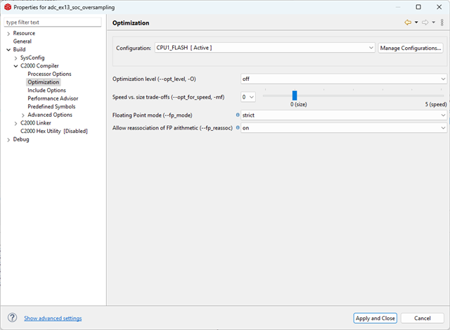

  • Jason,
    Have you tried the memory allocation viewer in CCS, under view in the tool bar,
    Another thing to try would be to optimize for size vs speed in the project properties
    I'll also ask some of my co-workers in our SW tools team if they have any ideas based on their experience.
    Matthew

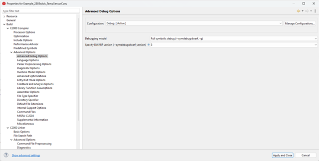

  • Jason,
    OK, I went back in with your feedback and have a new solution/proposal.  It looks like we can get what we what with the combination of the .out file(will contain dwarf and word sizes) and the map file(layout and symbol addresses).  Here are the steps we need to add to your build process
    1)Make sure that -g option is present in the compiler options; in our examples this is set but we need that info in the .out file for below to work.  I've added screen shot at the end of this post to show where that is in the build options of CCS(right click on the project and select properties to bring up this dialogue)
    2)We will use the XML based "map" file.  Tools team has advised that this format is more reliable for parsing vs just the .map file.  Again, this is enabled already in our examples, but I've shown where this is(in the linker options) in case you don't have it
    -Most likely both #1 and #2 are already in place for your build, based on our example usage, but I don't want to assume anything.
    3)I've attached an updated python file that take both the .out and the .xml file and parses for orphaned sections, but also gives the name of all the locals so you can go back and modify your code.  I'm placing the syntax of the python call below; for now since we are most concerned with DP usage I've set the option of --section .ebss.  If this is left blank the script will operate on the full output.
    4)Usage note:  This is more for others, currently this script will only work for the .coff based outputs like on F2803x(Gen1 and Gen2 C2000 MCUs).  I need to do some more work to support ELF outputs as those changed the reference formats.
    Python usage:
    python dp_frag.py --xml myproject_link.xml --out myproject.out --section .ebss --html report.html
    -g option:
    -xml option
