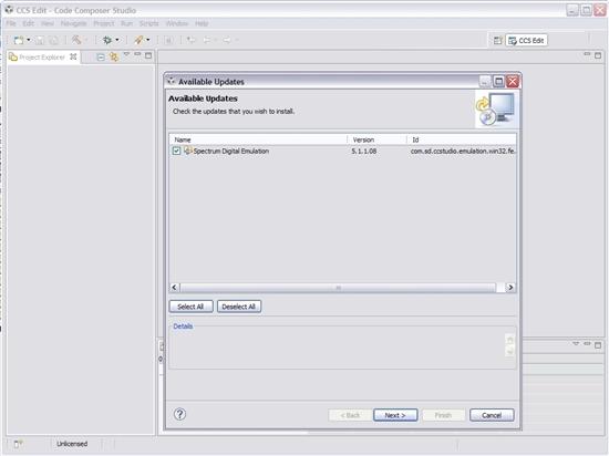

    This is all I see when I do an update via CCS v5.

  • Hi Oscar,
    you can go ahead and apply this update, even if it is the wrong one.  Actually some cgt tools are misleading and under and "emulation" update.
    Yes, get the folder from you colleague and install it under Window->Preferences->Code COmposer Studio->Build->Compilers and select add.
