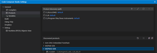

  • Hi Sebastien,
    Your available SDK settings would be shown in the File -> Preferences -> Code Composer Studio Settings
    I wasn't able to recreate it with just the latest version of CCS. Please, send your SDK and Sysconfig versions.
    -Eric Rentschler

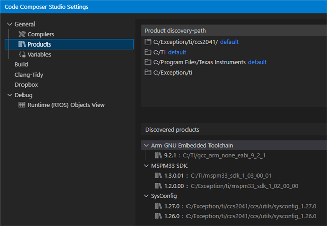

  • Hello Eric,
    ok, so I have:
    Have a nice day
    Sebastien
  • Hi Sebastien,
    Those version match what I have on my end, but I'm not able to recreate your issue. Can you send your .sysconfig file?
    -Eric Rentschler
