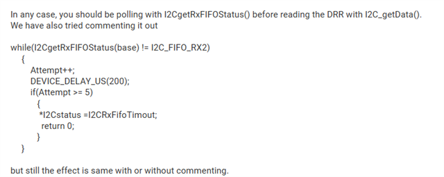

    In any case, you should be polling with I2CgetRxFIFOStatus() before reading the DRR with I2C_getData().
    We have also tried commenting it out
    while(I2CgetRxFIFOStatus(base) != I2C_FIFO_RX2)
             Attempt++;
             DEVICE_DELAY_US(200);
             if(Attempt >= 5)
                 *I2Cstatus =I2CRxFifoTimout;
                  return 0;
    but still the effect is same with or without commenting.

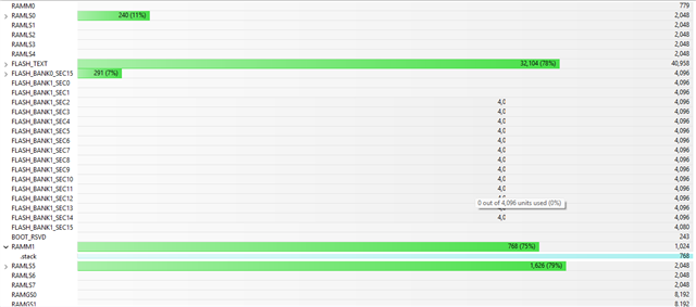

    We have analyzed the memory allocation window and stack usage window as well. There is no exceeding of stack boundary.
    I have used stack painting in the first line of main() fucntion and made all the stack section values as 0xAAAA and halted in the middle of the execution and checked the memory browser and approximately 72 bytes are left that are painted and all other values have changed to values and during execution all values are changing and there is no overflow.
    I tried increasing the stack size and there is no effect as well. In memory allocation we have used only 75 percent of the stack and 78 percent of the flash memory and our code runs on flash memory only.
    The below line is from linker file
       RAMM1           : origin = 0x000400, length = 0x000400     /* on-chip RAM block M1 */
    The below line is from map file
                  ORIGIN    LENGTH
    .stack 1 00000400 00000200
    I have attached linker file as well

    i have attached the memory allocation of the project as well.

    To help rule out memory related issues, can you explicitly move the .stack to .TI.ramfunc or some larger RAM area to see if that fixes the issue?
    Quick clarification here, commenting out those lines of code isn't the same as polling BEFORE receiving the data. Please try that explicitly.
    Is that the memory allocation while the project is running?

  • Hi Aishwarya,
    I have moved the .stack to some larger RAM area and it didn't fix the issue. I used the below RAM which is double of the previous memory.
       RAMLS7      : origin = 0x00B800, length = 0x000800
    I have also increased the stack memory but still it didn't work.
    We tried explicitly polling the Rx fifo before reading the data but the effect is the same.
    The memory allocation picture that I have uploaded is not during execution and I have checked the stack pointer while in debug mode it always stays in the stack memory region boundary only and it didn't overflow even in timer ISR or other interrrupts that we use.

    You only mentioned you commented out the following:
    If you have already made this change, then make sure you make a similar change when interfacing with TX FIFO, so poll I2CgetStatus() for the I2C_STS_BYTE_SENT flag or equivalent before issuing the repeated start. On every bus timeout/error, you should send a stop condition and reset the I2C module.
    I already explained this as well, but by modifying the functions you are changing the location of the functions, into a different 128-bit Flash alignment boundary. You can check your flash wait state/other configurations to probably see there are some wait state stalls that the I2C_getData function is being affected by. This is causing timing issues where the function is called BEFORE the I2C RX FIFO is populated. The subsequent while loop then times out because the FIFO is empty.
