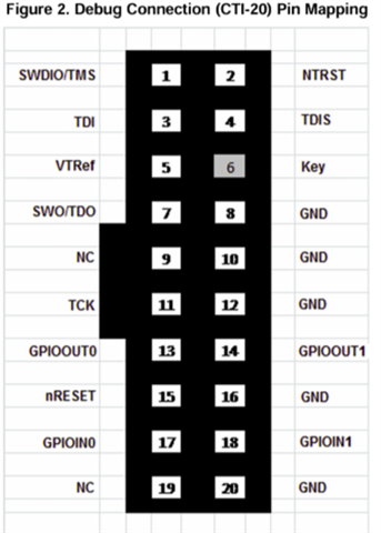

  • Hi Woojun,
    Can you check the following XDS110 connections:
    • CTI-20 pin 1: SWDIO
    • CTI-20 pin 5: VTREF
    • CTI-20 pin 8, or 10, or 12, or 16: GND
    • CTI-20 pin 11: SWCLK
    Additionally, please ensure all grounds are shared between the XDS110, target device, and external power supply.
    Lastly, how long are your programming cables? We generally recommend these not be longer than 30cm, as anything longer may mess with timings. You can also manually lower the SWD speed from the target configuration file by selecting the debug probe and advanced options.

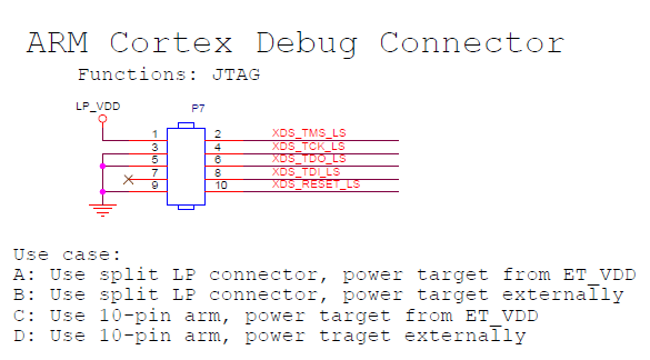

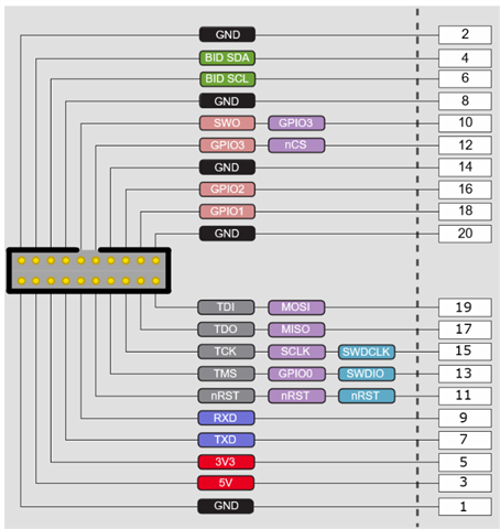

  • Hi Woojun,
    Apologies, I was thinking you were using the following version of the debug probe: TMDSEMU110-U Debug probe | TI.com. This uses the pinout shown on the right. It looks like youre using the LP-XDS110ET.
    From the schematic:
    It appears to match the graphic on the left. Does that configuration work? I will say this specific XDS110 version was meant for Wireless connectivity MCUs, but I believe it should still work with MSPM0.

    It seems that 20-pin connectors are for debugging launch-pad. And I noticed that there is a 10-pin debug connector that allows for a custom board. However, I could not locate that pin information. Could you guide me to use that 10-pin debug connector before my newly ordered debug probe arrives?
  • Hi Woojun,
    Here is the pinout for the 10-pin connector for the LP-XDS110ET:
    All design files for this debug probe can be found here: LP-XDS110ET Development kit | TI.com
    Brian

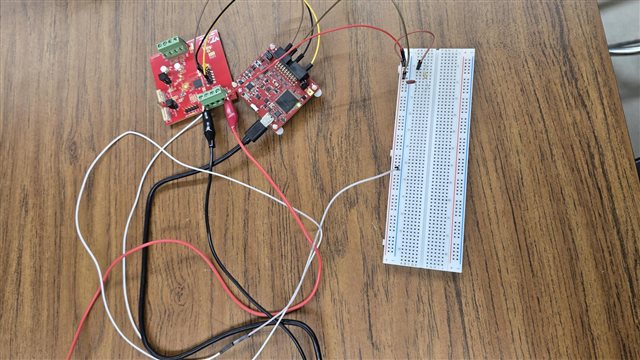

  • Hello Brian,
    I made this connection but it is still not working.
    I would need to purchase alternative debug probes other than TMDSEMU110-U Debug probe | TI.com, since this is out of stock now.

  • Hi Woojun,
    The XDS110 attached to any of our MSPM0 launchpads will work. The cheapest will be the LP-MSPM0L1117 Evaluation board | TI.com with all standard connections (GND,3v3,5v5, TX,RX, NRST,SWDIO,SWCLK, and BSL).

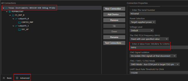

    1. Can you disconnect all jumpers J101 and use your jumper wires to connect the custom board directly to the XDS110 side of the LP instead of the 10-pin header on J102?
    2. Does adjusting the speed of the Connection properties of the XDS110 in the .ccxml still result in the same error? By default, the XDS110 is also set to have power supplied from the target so external power to your mcu is still required.

  • Hello, Brian.
    1. I tried both connecting J101 to mspm0G1507 and J102 with msmpm05G107 but neither of them works. However, using J101 to debug mspm0g3507 on the launchpad works, which means the xds110 debug probe is working. Therefore, it must be the problem in the connection between my custom board and the xds110 debug probe.
    2. I tried adjusting the clock speed and the power setting. I tried feeding vtref from 10 pin cortex pins to the mspm0 and external power supply to the mspm0. However, neither of them does not work. It consistently throws The value is '-615' (0xfffffd99). The title is 'SC_ERR_SWD_PROTOCOL'.
