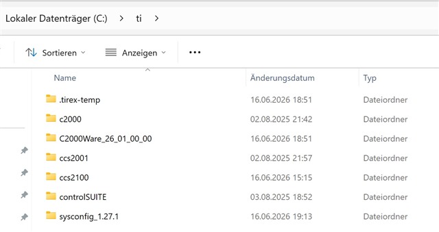

    Yes, I have two versions of C2000Ware installed. One is version 26.01, located directly in the Ti folder, and the other is version 5.02, located in the c2000 folder. But neither of them has a “common” folder.
    I also installed it on a brand-new Windows machine, but it doesn't work there either.

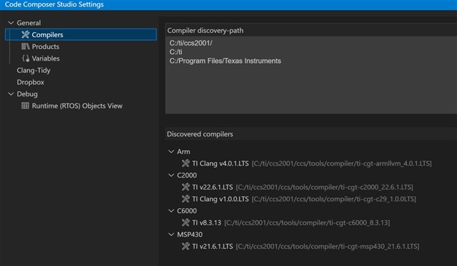

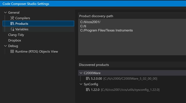

    Here are 3 more screenshots:
  • What version of C2000ware and Code Composer Studio do you have?

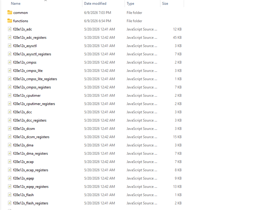

    Please use c2000ware 26.01 as it is the latest. I suggest using CCS 20.5 or later. Also the correct installation of c2000ware should have the "common folder" in it. For example, this is in my installation of c2000ware
    I think c2000ware was not correctly installed on your system. Can you try to install it from ti.com again and delete the old existing installation?
