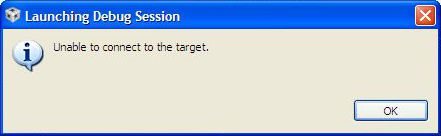

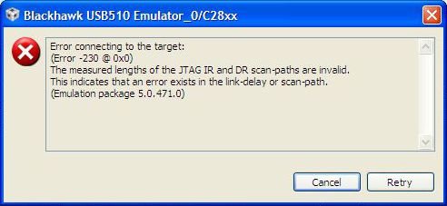

This is the error message reported when I try to debug
I tried a second emulator (USB510 JTAG EMULATOR Part #: BH-USB-510) and had the same result.

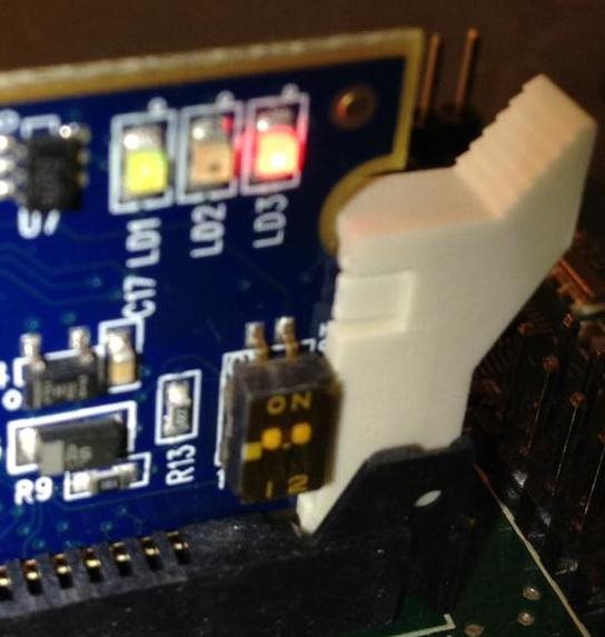

  • Here's one further observation.
    LD3 will blink (code running) when JTAG connector of Blackhawk USB2000 Controller is plugged in
    LD3 will not blink (code not running) when JTAG connector of Blackhawk USB510 Emulator is plugged in

  • Jason,
    We tracked down what we believe is the issue and are pursuing the fix.  In the mean time, if we can find something to use as a workaround, I will post it.
    The details....We beleive that USCIF v35.34.39.0 (underlying low-level emulation code if you are not familiar) introduced a change causing a problem with the sequence of establishing a good TCK rate.  This issue would affect any CCS version that is updated to USCIF 35.34.39.0 (we found no problem with USCIF v35.34.29.0 and earlier during our testing).  CCS updates that include this change must have been posted recently - we tested CCS v5 and v5.1 extensively before their release.
     - Andrew
  • Jason,
    Progress Update:  Working with TI, we uncovered the cause in USCIF 35.34.39.0 and have recomended the fix.
    Unfortunately, it is beyond our control to workaround these TI binaries.  We'll need to wait for TI to issue a CCS update for the emulation package.
     - Andrew

    Error connecting to the target:
    Error 0x80002240/-233
    Fatal Error during: Initialization, OCS, Control,
    This error was generated by TI's USCIF driver.
    SC_ERR_PATH_BROKEN <-233>
    The JTAG IR and DR scan-paths cannot circulate bits, they may be broken.
    An attempt to scan the JTAG scan-path has failed.
    The target's JTAG scan-path appears to be broken
    with a stuck-at-ones or stuck-at-zero fault.
    I/O Port = 0
    Board Name: Blackhawk USB510 - TCI6486-4 cpu Emulator
    Cpu Name: ICEPICK_C_0
    Abort: Close Code Composer Studio.
    Retry: Try to connect to the target again.
    Cancel: Remain disconnected from the target
    Diagnostic: Run diagnostic utility.
    Does it mean there is hardware connectivity issue , cpu is not reached through this path???
    please helps.
    regards
    mahesh
