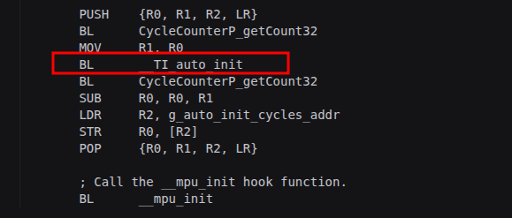

I'm measuring the cycle count of __TI_auto_init. The __TI_auto_init is called from the boot code.
When a particular function call is present in main(), the initialization takes fewer
  cycles (~448K). When that same function call is commented out, initialization takes more cycles (~555K) — a difference of ~107K cycles.
This is counterintuitive because removing a function call makes the binary smaller, yet initialization becomes slower.

The __TI_auto_init function is here:  Utils/boot_armv7r_asm.asm
