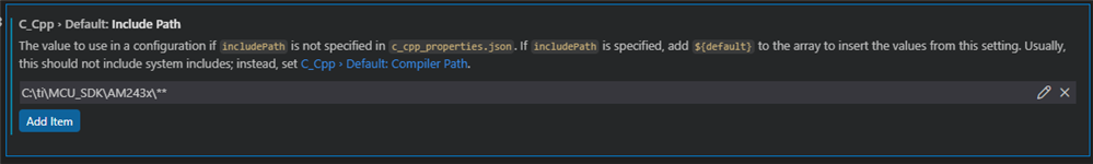

  • Install the C/C++ Intellisense extension on your VS code setup. Refer image below.
    Go to settings of the extension and add path for source directory to refer which in you case will be SDK path and workspace path.
    Refer image below.
    Open the SDK and CCS workspace project/folder in VS code using Add folder to workspace option.

    However, while this manual method works for simple examples, it is not very scalable or user-friendly for complex projects like the AM335X-TMW-IEC61850-DEMO or other heavy industrial protocol stacks.
    Specifically, I have two major concerns with the manual includePath approach:
    Performance & Accuracy: Using recursive wildcards (/) for the entire SDK path forces VS Code to index thousands of irrelevant files, which severely slows down IntelliSense and often leads to incorrect symbol definitions.
    Missing Macros: This method completely ignores the predefined compiler macros and project-specific #define symbols configured in the CCS build settings. Without these macros, VS Code cannot correctly evaluate #ifdef / #ifndef branches, leaving large chunks of active code grayed out.
