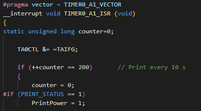

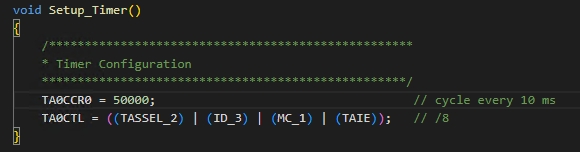

Wanted some quick clarification on how the print speed based on 'counter' incrementation is calculated using the MSP430 Timer in the following code snippets:
In the main.c file:
In the sys_init.c file:

    Looks like the timer being used in this file is the MSPM0's TIMER0_A1. I have noticed that if I reduce the value of TA0CCR0, the log being printed using the main.c file prints at a faster speed. I want to understand how to calculate the exact speed of the printed log based on the value of TA0CCR0 and how often the counter increments and resets back to 0 (the if (++counter == __) statement).
    Hope this provides a little more clarity on my question. This project file can be downloaded here: SLVC771 Code example or demo | TI.com
    Anagha

    You can use the formula to calculate the time for everytime the ISR triggers. In this case:
    Timer Period = (TA0CCR0 + 1) / Clock_Hz
    Assuming Clock_Hz = 1MHz, and TA0CCR0 is set to 50000, the result for the timer period will be around 50ms (not sure why the comment there says 10ms, the original example code is 50ms).
