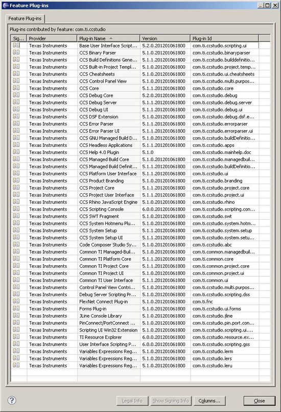

  • Hi Lisa,
    I was using eclipse 3.7.0, now with 3.7.1 ist works.
    But there is one more problem now. When trying to debug I always get the following error message:
    Manuel
  • Installed plugins and error log:

  • Hi Manuel,
    do you also get this if you manually try to launch a debug session? Ie if you launch the target configuration or start from the debug perspective?   Did you create a CCS project?
    Lisa
  • Dear Lisa,
    I'm not using a CCS project, its a makefile projekt. I started the debug session via "Debug Configuration" window with a "Code Composer Studio - Device Debugging" target configuration.
    After installing CCS 5.0.9 instead of 5.1.1, everything works fine!
    Do I need 5.1.1 bugfixes for C2000 MUCs?
    Manuel
  • Hi Manuel,
    no, you do not specifically need 5.1.1 for C2000 coding.  Of course we always recommend being up to date but if 5.1.1 is problematic for you, then I would suggest skipping this update for now and grabbing a later release.  The code generation tools are installed alongside CCS and are actually separate entities you can update yourself so you should be fine to use 5.0.9.
    I am glad to hear you have a working environment and hope the above helps clarify for you.
    All the best with development.
    Best Regards
    Lisa
