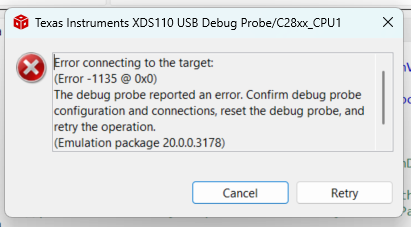

I started getting this error out of the blue.  Several weeks into trouble shooting.  I have tried 2 XDS110 and 2 PCB assemblies know to have been working previously, all with the same error.  I rebooted my laptop and tried again with the same results.
Test connection reports no errors. (see below).
What else do I need to look at?

    Please take a look at our JTAG Connection debug document. Specifically table 4-1 which states some steps you can take to help debug the issue.
    Kind regards,
    AJ Favela
  • These are the debug steps for this error:
    This error message is usually caused by hardware related issues. Verify that VDDIO/VDD are properly supplied. Confirm that XRSn is asserting high, indicating that the device is properly coming out of reset. Long JTAG cables, improper termination, or excessive capacitance can also degrade the JTAG signal integrity as well.
    All of these things are OK. VDD is in spec, XRSn is high and the cable is about 6 inches long.  i've been using this style cable for years without problems.
    Would the test connection pass if these were not ok?
    Have you made any changes to your .ccxml file between the connection working and failing?
    Additionally, can you place your device into waitboot mode if it isn't already? This can be done by following the table below.
    Kind regards,
    AJ Favela
