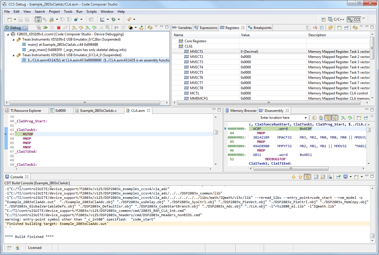

I am having some troubles debugging cla in CCSv5.
I am using
CCS 5.1.0.09000
Compiler TI v6.0.2
Piccolo F28035PN
BH-USB-560M
When I debug some code from the cla I have no symbols at all for the cla code. OK for the CPU code.
Looking at the registers of the cla there's no way to show their values in float format.
When I'm stepping throught the code, the values in the registers change three instructions later. This may be because the pipeline, but if this is the case, how can I follow the values of the registers of the three instructiuons before MSTOP instruction?
