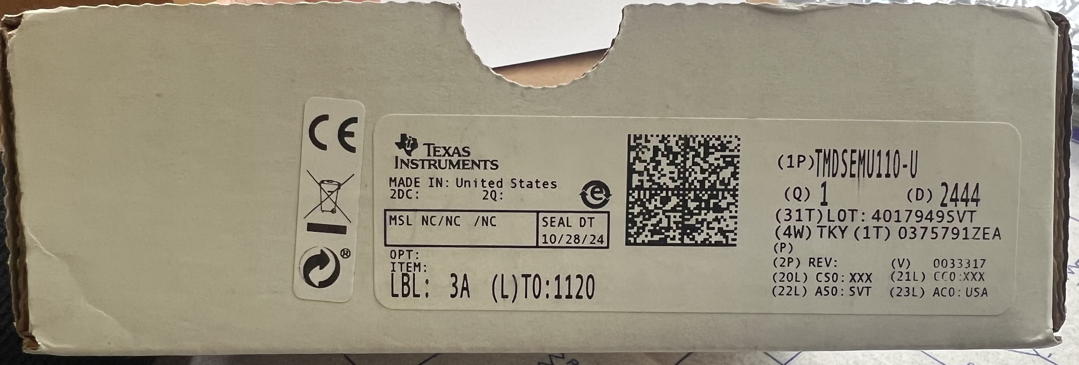

Description of the issue: The unit stopped working. It is unable to program the target device. When attempting to push the code, received "Error -267 @ 0x0." We are lucky to have purchased two XDS110, the second unit is working fine.

  • Thank you Fleenor, please see below
    1. Have you tried without the USB Hub to rule out any hub-related issues? We did not use USB HUB
    2. If you check, "Apple menu → About This Mac → System Report…" does the probe populate on the list of connected hardware? We don't see in the list
    3. What version of Code Composer Studio are you running? We use Web based UniFlash
    4. What versions of the XDS FW are running on both debug probe devices?
    5. When the error occurs, does UniFlash recognize and detect the XDS110 probe, or does it fail to detect it altogether? fail to detect
