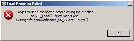

    I tried to set up a debug configuration but it didn't work. There doesn't seem to be any documentation on how to use this with CCSv5.1 and multicores. The Help->Search finds something under C/C++ development which doesn't help much. The E2E forums have a couple of posts that are simply confusing and seem to be for CCSv4.
    Here's what I did:
    1. Run->Debug Configurations...
    2. Duplicate evmc6678l_xds100.ccxml to create evmc6678l_xds100.ccxml(1)
    3. Uncheck all but core 0 and 1.
    4. In the program tab, define the programs I want to load on the two cores.
    5. Save everything.
    Then I use the bug icon and select evmc6678l_xds100.ccxml(1) but it gives me an error dialog box ("disconnected.bmp" attached) that says that the target must be connected first. So, I connected to the target and use the bug icon again and I get another error ("connected.bmp", attached). This tells me that the existing debug session must be terminated first. I click OK and then get the first error again.
    So, how do I use Debug Configurations?
    I have pasted the two bmp files below. If that doesn't work then I'll try to send them another way.
    Fred

  • Fred,
    I posted a short clip that shows what I meant in my reply. Please check the clip Multicore debug launch made easy in the section Debugger of the Tutorial Videos page below:
    http://processors.wiki.ti.com/index.php/Video_Tutorials_CCSv5
    (It doesn't look as nice as the other videos as I couldn't figure out how to embed it in the html).
    Check it out and see if it helps with this process.
    Rafael
  • Thanks. That works. It also works with a separate project for each core instead of one project with separate targets as in your example.
    Good luck figuring out how to embed it in the page. The link is almost invisible in the middle of the big embedded video windows.
    Fred
