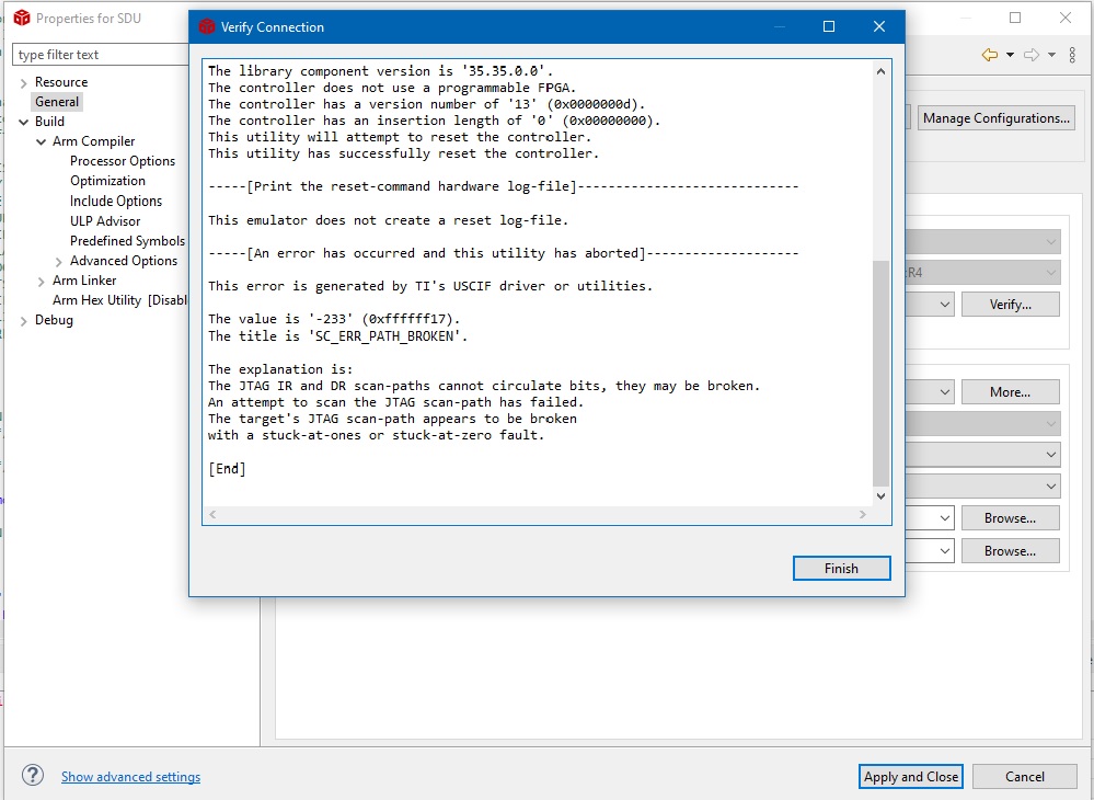

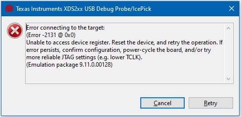

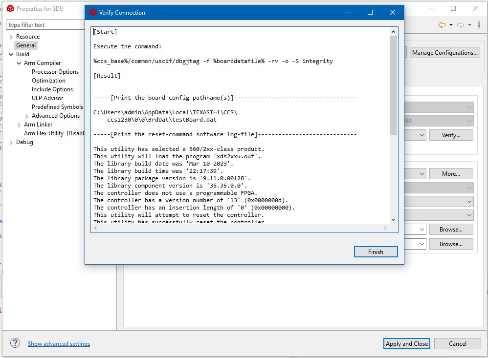

Theese is an Error -2131 (Unable to access device register) which indicate that Code Composer Studio (CCS) is communicating successfully with the XDS200 debugger, but the debugger cannot establish a stable connection with the target chip on your card.XDS200 Debugger.jpgXDS200 Verify Connection1.jpgXDS200 Verify Connection2.jpg
