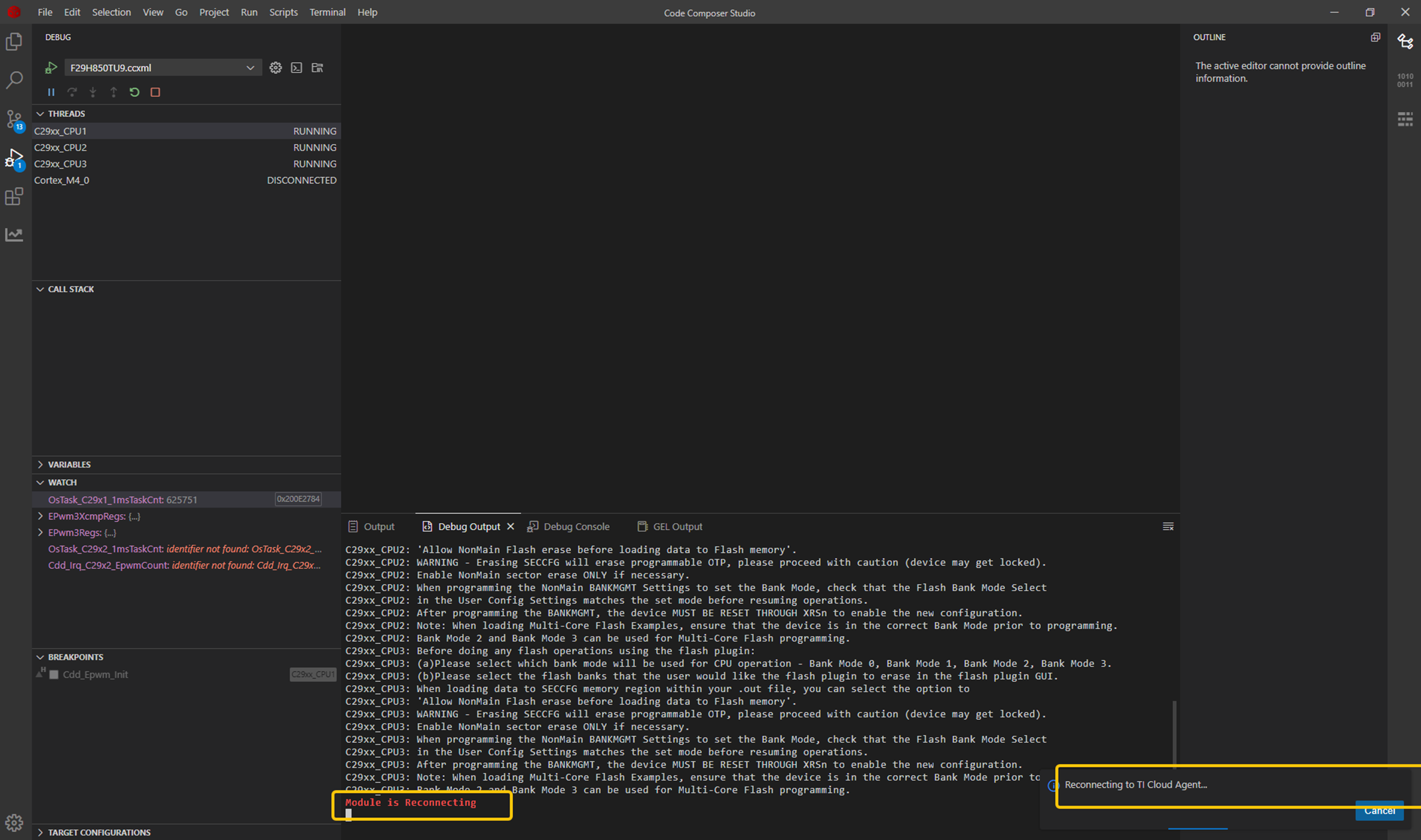

TI Cloud Agent is actually a required debug agent for debugging.
Just to confirm:
After debugging with the network disconnected, upon reconnecting to the network, a "Reconnecting to TI Cloud Agent..." prompt appears.
So everything works fine while network is disconnected and only when connected to the network does the issue occur? If you remain disconnected and never connect to network, all debugging is fine?
Ming - Please reproduce the issue with Debug Server Logging enabled. You need to explicitly turn it on first. See:
https://software-dl.ti.com/ccs/esd/documents/ccs_diagnostic-logs.html
Then zip the log and attach to this thread.
But why i didn't need TI Cloud Agent, but Ming need it?
TI Cloud Agent is always used under the hood. Note that it is used even if all communication is local. Please see: https://software-dl.ti.com/ccs/esd/documents/users_guide_ccs/ccs_faqs.html#i-see-constant-references-to-ti-cloud-agent-when-running-ccstudio-ide-on-my-local-environment-what-is-this-and-do-i-need-it
