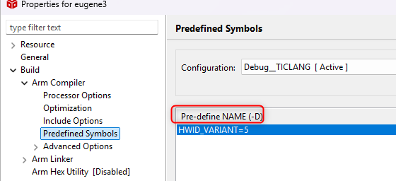

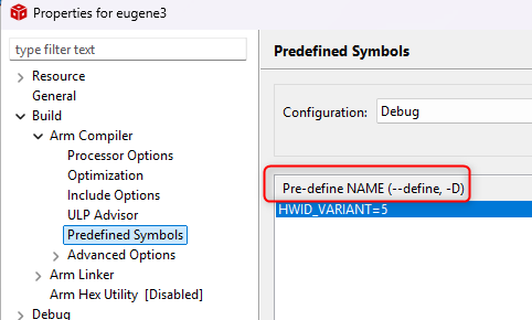

  • I see my error.
    -ccs.setCompilerOptions "--define=SYMBOL=VALUE"
    --define is for the old TI Arm proprietary compiler. It does not apply to the newer TI Arm Clang compiler.
    TI Arm proprietary compiler:
    TI Arm clang compiler:
    Sorry for the confusion.
