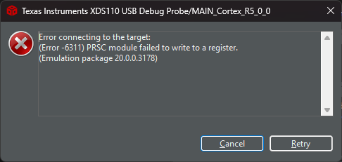

We are trying to get PX5 RTOS running on the Cortex-R5 of the AM64x Evaluation Module for a mutual customer in the industrial control space. We have found a series of examples and can build them cleanly with our CCS 12.4 tools. However, whenever we try to download them via Debug As -> Code Composer Debug Session, selecting only the MAIN_Cortex_R5_0_0 we get a series of errors, starting with:

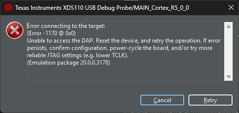

Attempting to disconnect the XDS110 debug cable and reconnecting, followed by Retry, we get:
The board SW settings are:  SW2 all on, except for 3   SW3 all off
We have spent a day fiddling with this, but we suspect we are just missing a fundamental set somewhere in the sequence.  Any help would be greatly appreciated!!

  • The board SW settings are:  SW2 all on, except for 3   SW3 all off
    It looks like you don't have the correct boot mode setup on EVM and I feel the SOC is also not initialized.
    Please refer EVM_FLASH_SOC_INIT guide to initialize the SOC. The boot mode settings and steps to initialize are documented in the link.
    Once the SoC is initialized, you should be able to load the examples via CCS JTAG.
    Let me know if you still face issues.
