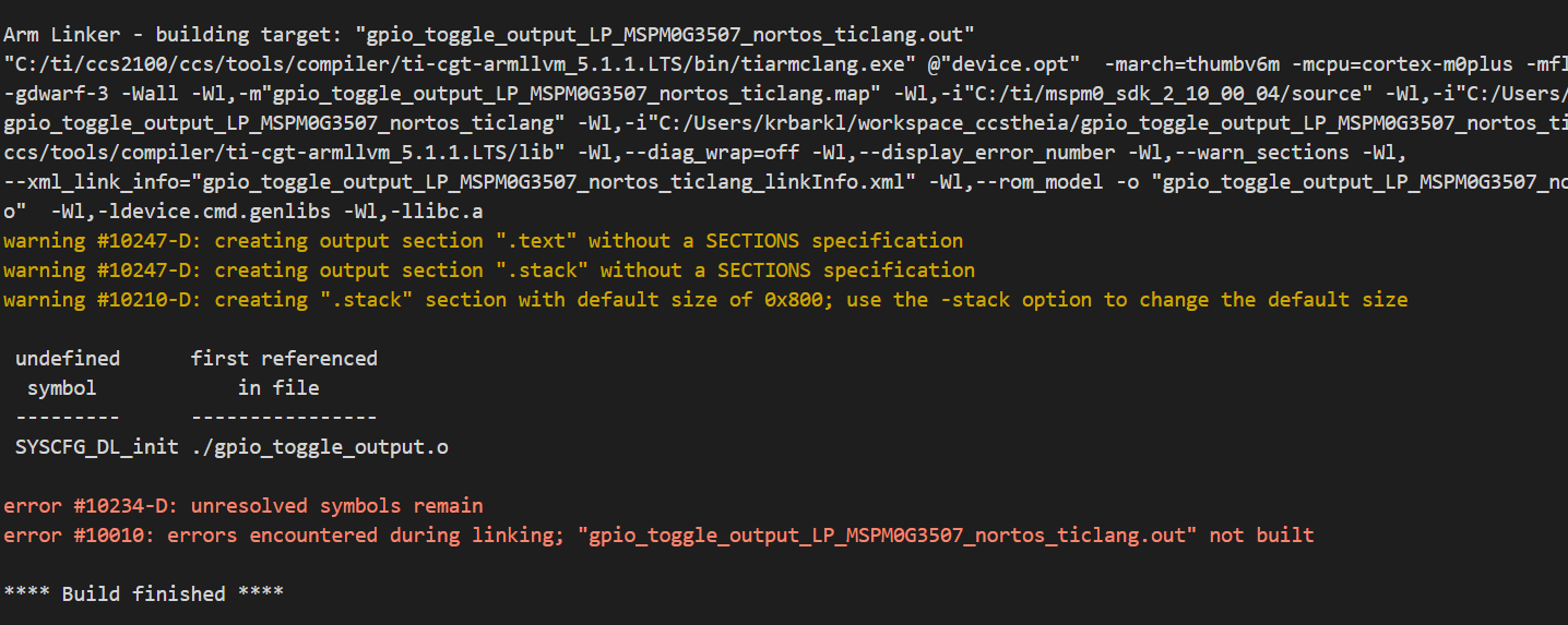

CCSTUDIO-THEIA: CCS 21 can't find SYSCFG_DL_init
Part Number: CCSTUDIO-THEIA
Other Parts Discussed in Thread: SYSCONFIG, MSPM33C321A
I don't know what happened. I built some projects this morning and everything was fine. (I believe I did click the update which I tought was just updating an SDK)
Now none of my projects in any of my workspaces for multiple MCU's cant find SYSCFG_DL_init(), or the .cmd file.
  • Hello Keith,
    So in your project now, you can find the SYSCFG_DL_init() and the cmd file, but when you build the project, it will report error? If you import one demo from SDK, will this error occur again?
    BR,
    Janz Bai
  • To test this I created a new workspace and imported a project. I get the same error as above when compiling.
    It looks like sysconfig created ti_msp_dl_config.c, but I *don't* see a ti_msp_dl_config.o.
    And this happens with every project.
    It only started happening when I accepted the update yesterday and installed a new wireless sdk, I think.
    There must be some global setting I am missing, but I am not sure which one.

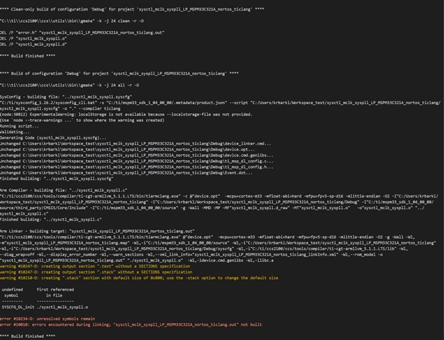

    When compiling the last project, do you see ti_msp_dl_config.c being compiled in the build output?
    Arm Compiler - building file: "ti_msp_dl_config.c"
    "C:/ti/ccs2100/ccs/tools/compiler/ti-cgt-armllvm_5.1.1.LTS/bin/tiarmclang.exe" -c @"device.opt"  -mcpu=cortex-m33 -mfloat-abi=hard -mfpu=fpv5-sp-d16 -mlittle-endian -O2 -I"C:/Users/a0389327/workspace_ccstheia_21/sysctl_mclk_syspll" -I"C:/Users/a0389327/workspace_ccstheia_21/sysctl_mclk_syspll/Debug" -I"C:/ti/mspm33_sdk_1_04_00_00/source/third_party/CMSIS/Core/Include" -I"C:/ti/mspm33_sdk_1_04_00_00/source" -g -Wall -MMD -MP -MF"ti_msp_dl_config.d_raw" -MT"ti_msp_dl_config.o"  @"./device.opt"  -o"ti_msp_dl_config.o" "ti_msp_dl_config.c"
    Finished building: "ti_msp_dl_config.c"
  • So, I added a GPIO to Sysconfig to make it "dirty" as well as a comment in the main .c file to touch it, too
    It does compile the sysconfig
    but, it says that
    "Unchanged C:\Users\krbarkl\Workspace_test\sysctl_mclk_syspll_LP_MSPM33C321A_nortos_ticlang\Debug\ti_msp_dl_config.c..."
    I added a GPIO, it should certainly be changed.
  • Did not help. Should I clear out the debug, too?
    I tried my main workspace and the test workspace I created to debug this.
  • can you attach the "makefile" and the other four *.mk files in the Debug configuration folder after the build?
    Are you importing a project directly from the SDK?
  • Yes, I created a new workspace and imported an example directly from the ti folder.
    For these make files I added a GPIO and a comment to the c file to force a complete rebuild.Makefiles.zip
  • Your makefiles do not reference the generated sysconfig files for some reason.

  • Interestingly, when I look at the makefile in the zip, it is missing the references to the generated sysconfig files. Then when I import the project to my workspace, it looks like CCS regenerates the makefiles and the makefiles looks correct.
    I am at a loss what is happening. I'll need to follow up with engineering.
