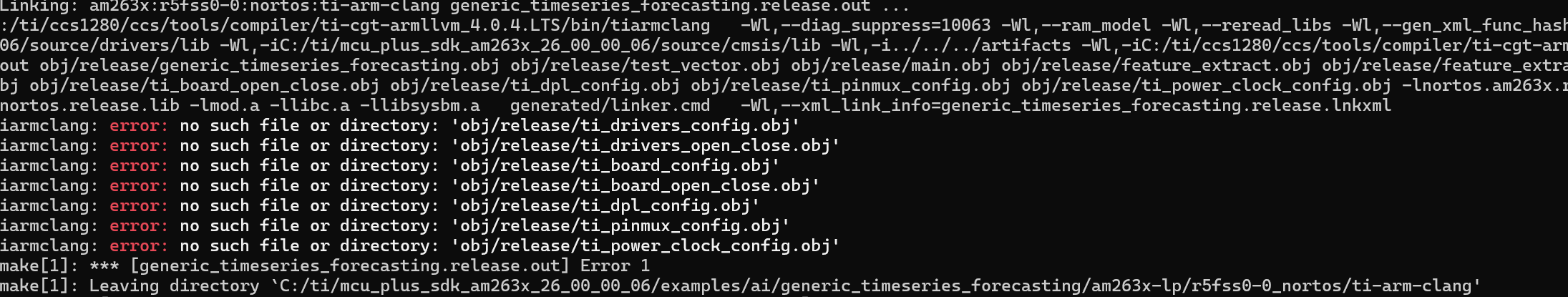

We are facing this issue while compiling the mcu_plus_sdk_am263x_26_00_00_06 same has been noticed in other SDK as well.
Is there somthing we are missing.
Please help.
Hi Aakash,
1. Can you please help me understand what exactly are you compiling out of the SDK? Looks like your sysconfig files did not get generated. Can you share the complete log?
2. Are you compiling via command-line or in CCS ? If command line, what exact command are you using?

Yes
It was related to the make version I was using, I had 3.81 now I am using 4.1.
