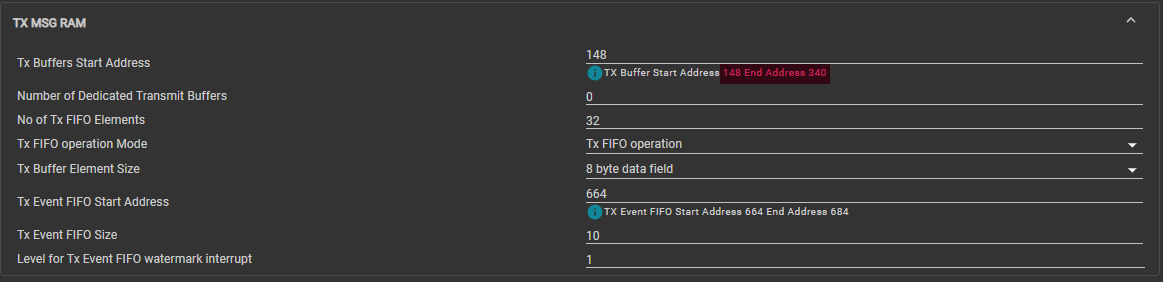

while working on the RAM configuration for the MCAN RX/TX buffers, we recognised that the end address of the buffers was calculated incorrectly, which made the layout quite difficult.
For example the TX Buffer:
According to this calculation, the buffer would be 192 bytes wide. Taking into account that the buffer stores 32 elements, each element would be 6 bytes in size. However, according to the datasheet, each element stores 8 bytes of overhead plus the number of actual data bytes (in our case, 8). Therefore, the correct element size would be 16 bytes, or have
we overlooked something?
BR Christian
SysConfig version: 1.28
CCS Version: 21.0
Controller: F29H850TU
