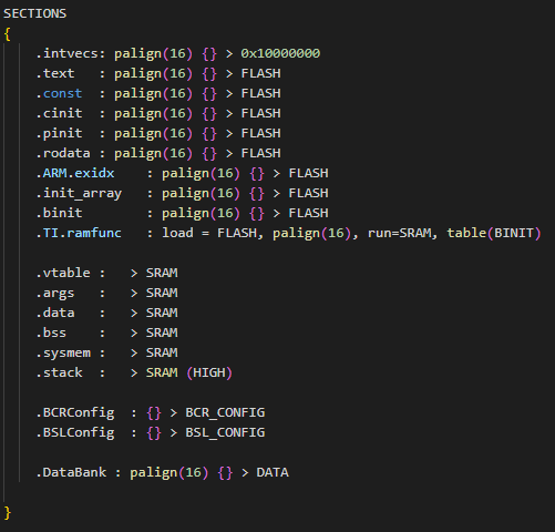

I'm working on MSPM33C321A on CCS, I have declared a structure where inside there are other structures, like this:
typedef struct
  sStructure1                 S_struct1;
  uint16_t                      u16Data1;
  sStructure2                 S_struct2;
  sStructure3                 S_struct3;
  sStructure4                 S_struct4;
  sStructure5                 S_struct5;
  sStructure6                 S_struct6;
  sStructure7                 S_struct7;
  uint16_t                      u16Data2;
}MainStructure;
I check that:
sizeof(MainStructure) is not equal to sizeof (sStructure1) + sizeof(u16Data1) + sizeof (sStructure2) + sizeof (sStructure3) + .... + sizeof (sStructure7)  + sizeof(u16Data2)
But if the int16_t are moved by uint32_t, I have :
sizeof(MainStructure) = sizeof (sStructure1) + sizeof(u32Data1) + sizeof (sStructure2) + sizeof (sStructure3) + .... + sizeof (sStructure7)  + sizeof(u32Data2)
I checked in linker file, and the alignment are declare on 16 bits
Could you tell me if it possible to fix this issue ?

    ok for that but why the compiler added paddings if it is aligned at 16bits ?
    If it was a 8 bits, I understood.
    How avoid to add padding, and the data are stored address by address ?

    The size of the struct is padded to a multiple of its alignment by default. You can avoid alignment padding between struct members by applying a "packed" attribute to the struct, like so:
             struct __attribute__((packed)) foo {
             } SSS;
    Going back to the example, suppose in the linker command file we have the following:
    MEMORY
    S_MEM : org = 0x20200001 len = 0x100000
    SECTIONS
       .mainStruct : { tryme.o(.data) } palign(16) > S_MEM
    S_MEM starts on an unaligned address. The palign(16) will force the definition of "MainStruct" to start on a 16-byte boundary even though the minimum alignment requirement for the struct is on an 8-byte boundary. Furthermore, the size of the .mainStruct section will be padded to a multiple of 16 bytes.
    This is reflected in the content of the map file:
    .mainStruct
     *        0     20200010 00000020 UNINITIALIZED
                       20200010 00000020 tryme.o (.data.MainStruct)
    If you want to avoid the padding caused by the palign(x) operator, you can use the align(x) operator instead.
